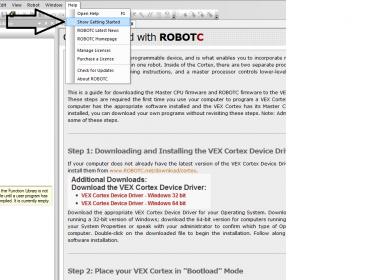

Thanks for the feedback.
Also more detailed instructions on how to update the Firmware on your Cortex are found under the help tab, within your programming software.
-Eli
