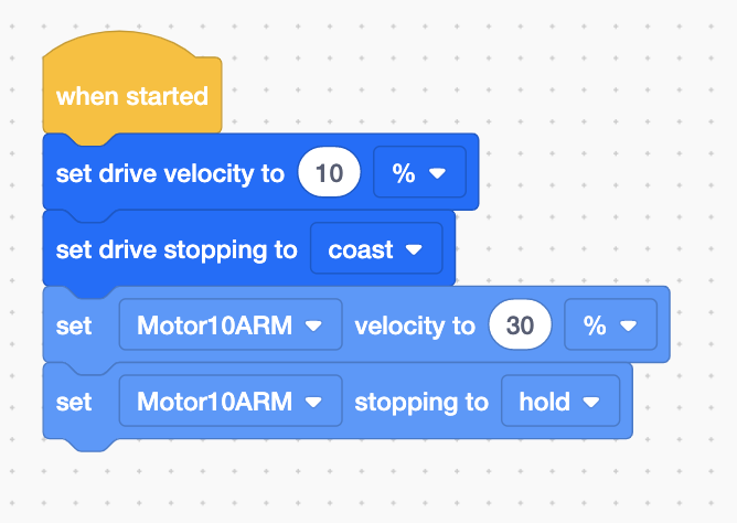

Here is my code:
Screen Shot 2022-04-22 at 4.20.43 PM
So, the thing about your code is that it’s effectively being overridden by the default controller operation, because you don’t have any code to programmatically determine speed.
Look at the VexCode examples for left stick arcade or tank mode controller, and these will give you the good starting point for when you’re trying to move beyond the basics.
