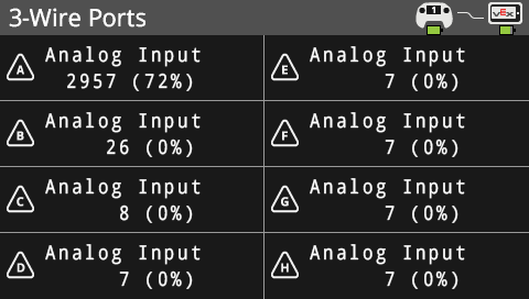

I just tried the code above, works here with no issues.
can you verify if the pot is working when you use the V5 dashboard ?
3wire
Make sure the connector is pushed all the way in, the 3wire connector should be flush with the housing.
Thank you jpearman! Yes I had been checking it against the dashboard & it wasn’t registering. Had kept telling the kids to make sure it was pushed all the way into the brain & they insisted it was. Should have checked myself - it wasn’t all the way in. Sorry & Thanks. Anyway, as far as declaring the sensors & controller, what is the correct way in VEX Code Preview… see my post above. Thanks :slight_smile: joan
