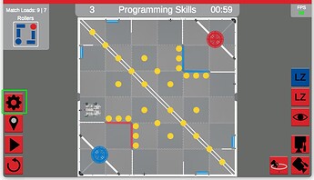

Can you please tell me what team number you are using to sign in? This will let me investigate what the servers are reporting and why you are unable to submit a score. You can find the current login by clicking the Gear button in Virtual Skills. The team number is directly under the Settings text.

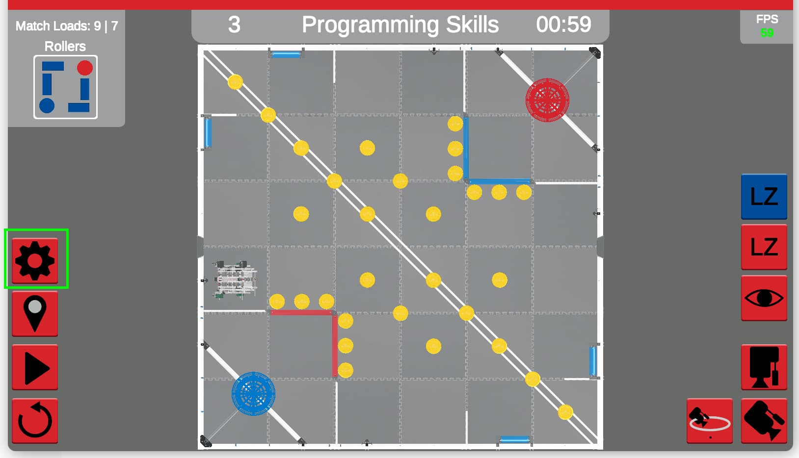

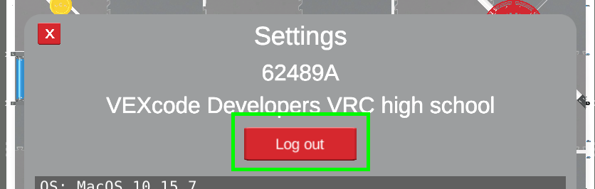

  1. open Virtual Skills
  2. click on the settings (gear) button on the left
  3. click log out
  4. try to log back in with your 20785X team info.
