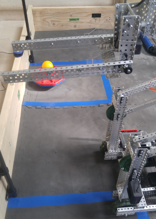

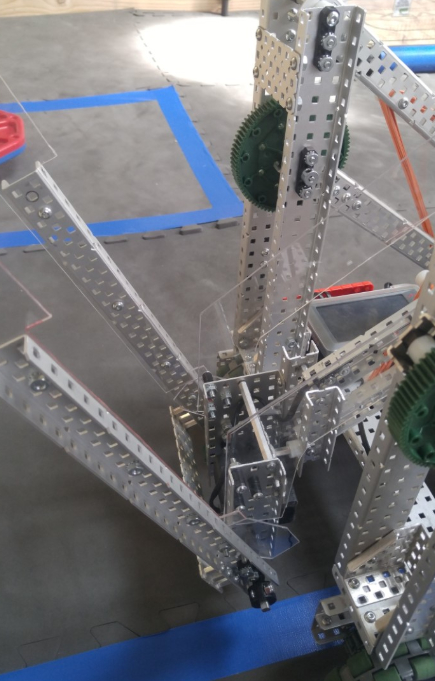

I just cannot figure out where to mount it without going over the 18 in limit. Attached is a pic of the front of the lift. When the lift folds down there is no room for a device.
[/quote]
#10
Great idea! Thanks! I just cannot figure out where to mount it without going over the 18 in limit. Attached is a pic of the front of the lift. When the lift folds down there is no room for a device.
![image|319x500]
#11
you could maybe mount it on the underside of your claw.
#12
+1, especially if you have an extra motor. Check out this video to see what he’s talking about:
OR, you could widen the top four-bar of your RD4B and put the post aligner thing about in the center of the robot.
#13
Why can’t it fit on a tower in the middle of the bot? It would be really skinny, except for the actual aligner, which will be pushed down by the lift because of its girth.
Do you have any more complete pictures of the robot? I’m trying to see if there’s anything blocking the hypothetical tower.
#14
The top four-bars would hit the top of the tower, if it was placed in the middle. To fit a tower, the top four-bars need to be spaced apart to fit it in between.
