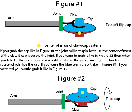

this isn’t my picture or idea and i forgot which person posted it so i’m sorry about
that
but claws that can grab caps by the top of the core should be able to passively flip over caps if put on some freely rotating axle/screw

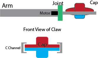

I was thinking about this and it could also be done this way probably more reliably, but it would take a motor.
#20
the problem with slotting those c-channel onto the cap’s edges like that is trying to pick up caps that are slanted on the ground. if a cap was in a corner and slanted, i think it would be pretty difficult to move the caps out
