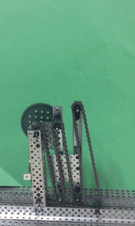

Ohhh, I missundertood the question. Cascade lifts are more modular than continuous lifts. Continuous lifts use one looooong chain that has to loop around. A cascade lift uses several small chains to get the same effect.
Cascade
Continuous

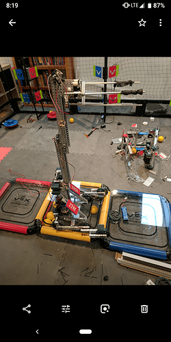

Should be possible with a single V5 motor and correct gearing. Here was mine from 2014

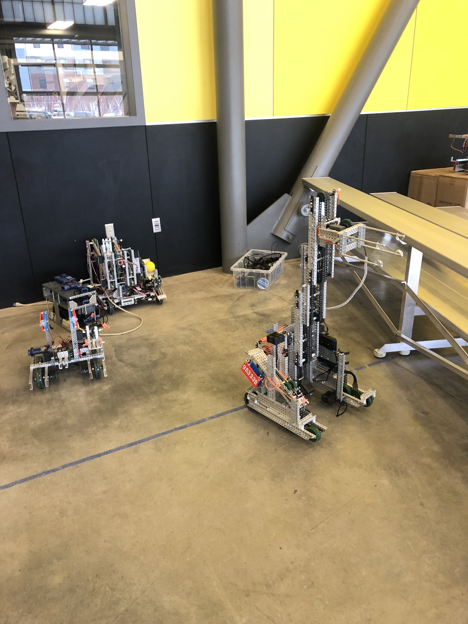

@jpearman I actually built your 3 stage cascade lift over thanksgiving break, and one motor was pretty fast. However, this was from loosening the slide trucks to reduce friction, so it’s wasn’t exactly stable. But if you tighten it up, add some grease, it’ll surprise you.
I only need 2 stages on the lift, do you think that would work?
quality and accuracy of the build makes all the difference. I found that adding washers to get exact spacing for the linear slides was really important, I had to try several times before getting it correct. I’m thinking of rebuilding again with V5 motors when I have a chance.
