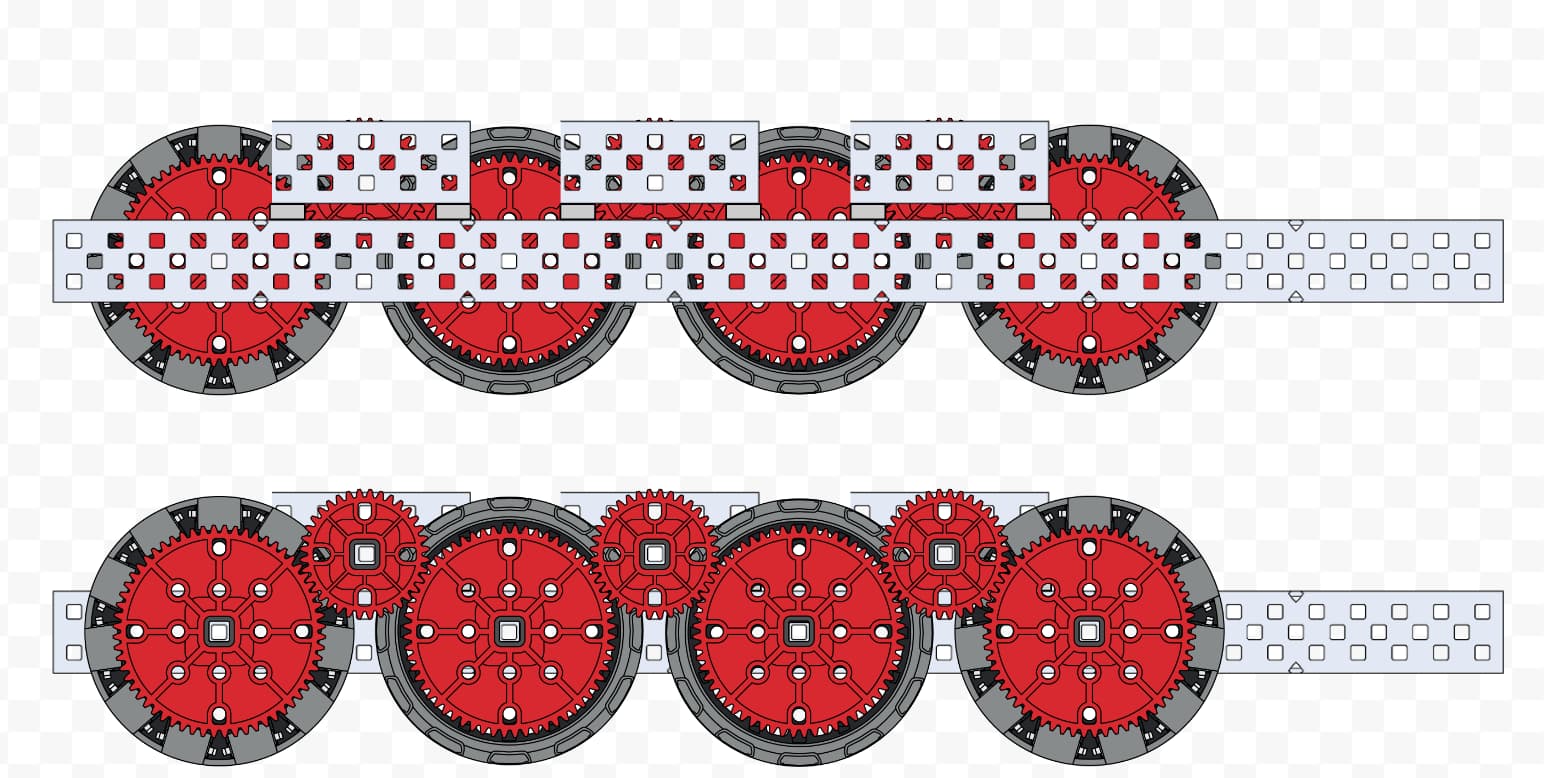

My team needed a more compact 360 RPM drive that still has 8 wheels so I quickly stirred this up in my head. Would this be a good alternative to the normal 360 RPM drive? I haven’t given this much thought and I don’t know if there is any major flaw that I’m missing. Thanks in advance.
This design looks super cool! Go for it, just try to put the battery/pneumatic tank(s) as low as possible to lower the center of gravity.
Since the motors (which I’m assuming will be driving those 36t gears) will be mounted up high, you will need to adjust for that in the rest of the robot design.
You also might have an issue with the driving gears being mounted on the top hole of the channel, I might suggest moving the wheels to the bottom hole of the channel so you can mount the motors in the middle hole
