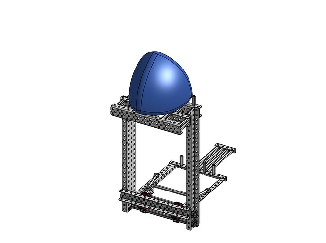

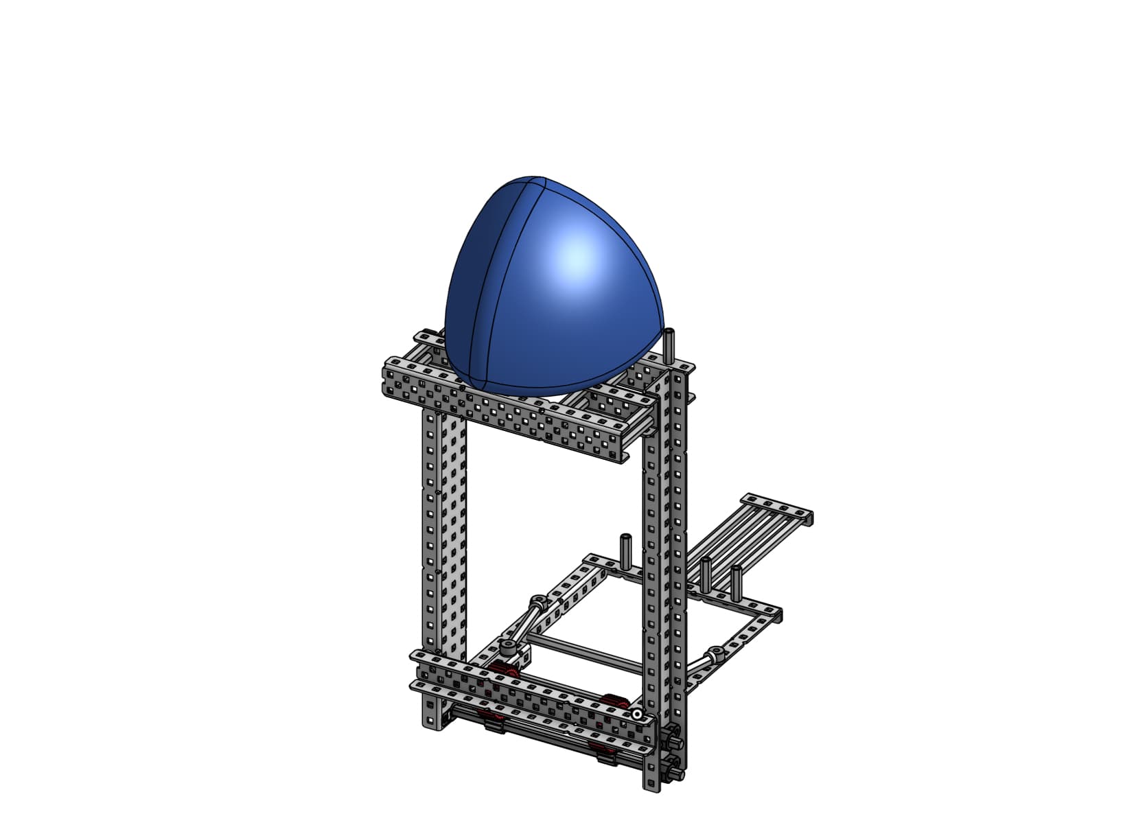

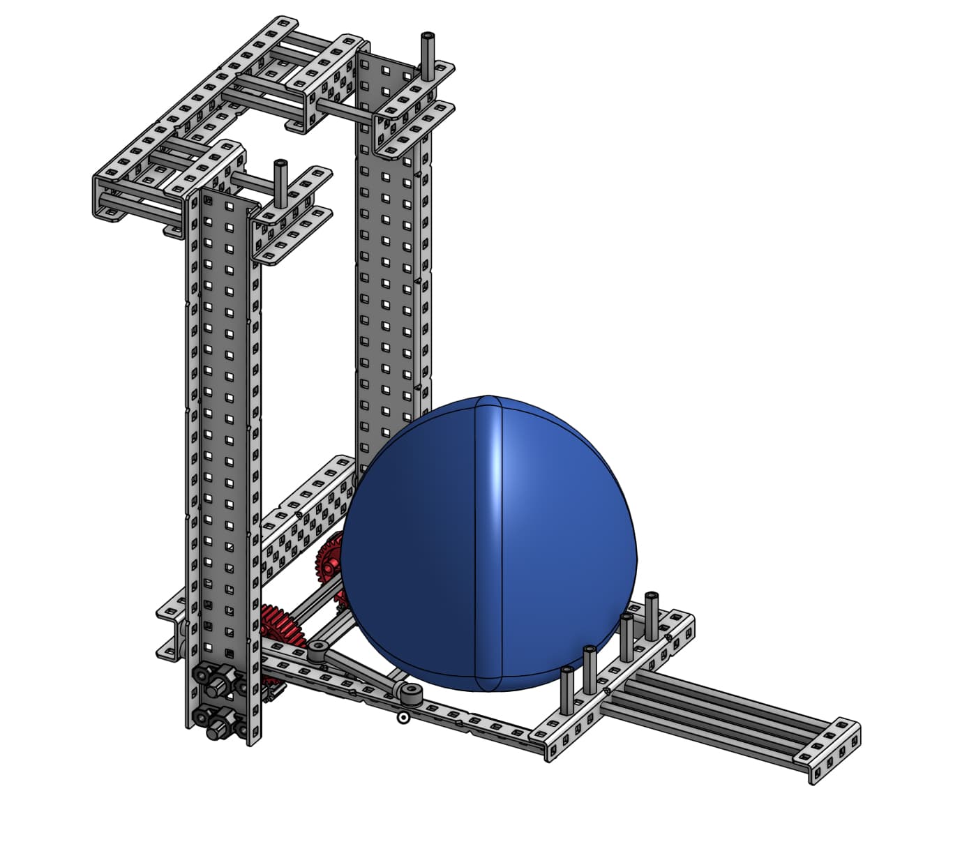

So, just an update. I decided to take a look 299V and what they were doing. I found their idea of a slapper and catapult combination was pretty cool so I used that as inspiration to model a prototype.
The basic ideas is that top is for match load to prevent getting blocked from opponents while the bottom is to shoot for low post goals. What are you guys thoughts?
On that note, would there be a way to make this more compact?
Certainly; it’s up to you to figure that out within the constraints of your robot.
I’ll give you a hint though: do the vertical pieces really need to be vertical like that? Does it need to be that long at all?
Actually, that does make me think. It doesn’t have to necessary be necessarily vertical, but an angle to be more compact. I was also thinking that instead of having standoffs, we could replace it with a piston, so that the longer arc can be activated only when necessary.
