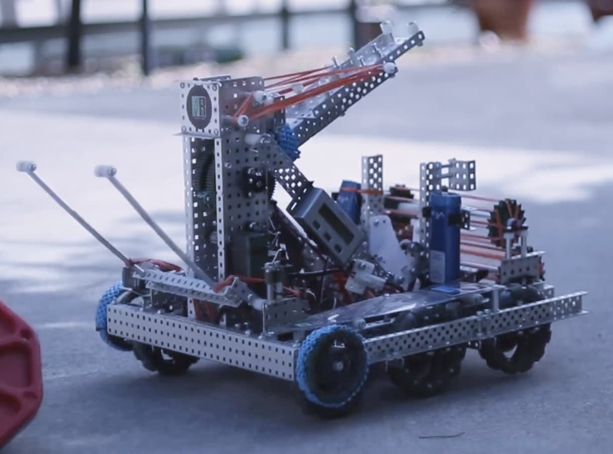

Hey guys I need help Getting my catapult to shoot farther and weve moved the mechanical stop multiple times and nothings worked any ideas?
probably a tension issue, not a trajectory issue. add more rubber bands, or increase whatever source of tension you’re using.
we had 12 ruber bands on each side and it was shooting maybe 2 feet in the air and we have no more rubber band. but yesterday we could shoot 4 ish feet in the air and thats with 3 disc instead of one disc like today.
your rubber bands have lost elasticity, they will perform terribly in comparison to new rubber bands.
they were new but I think they were over streched

if you stretch out your bands really hard and they are not of high quality, they will become worn out pretty quickly, which will lead to a loss in firing power over time.
Try reworking your tensioning system to have more bands stretching less distance, and maybe invest in some higher quality bands if you haven’t already.
ya ive ordered some bands but my next comp is nov 5 and ima need some help tensioning it but i think i know how to fix it we had the bands doing like a 180 but if i make it less tight but give the bands more of a 90 degree angle it should improve power

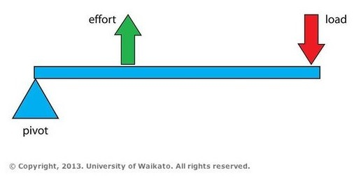

It looks like it’s the way you are applying the rubber bands to the arm. If you mount the rubber bands as far out as possible, you can have more power with less bands. On our cata we have only 3 bands on each side because we mount it farther out on the arm.
If you put the effort farther away from the pivot you will have a better mechanism:
Another thing you guys could change is the angle of the banding. It looks like you are banding over the center point, when you should band similar to this robot:
Notice how the bands are above the pivot point
