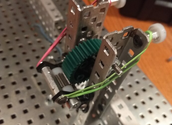

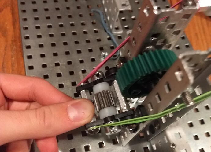

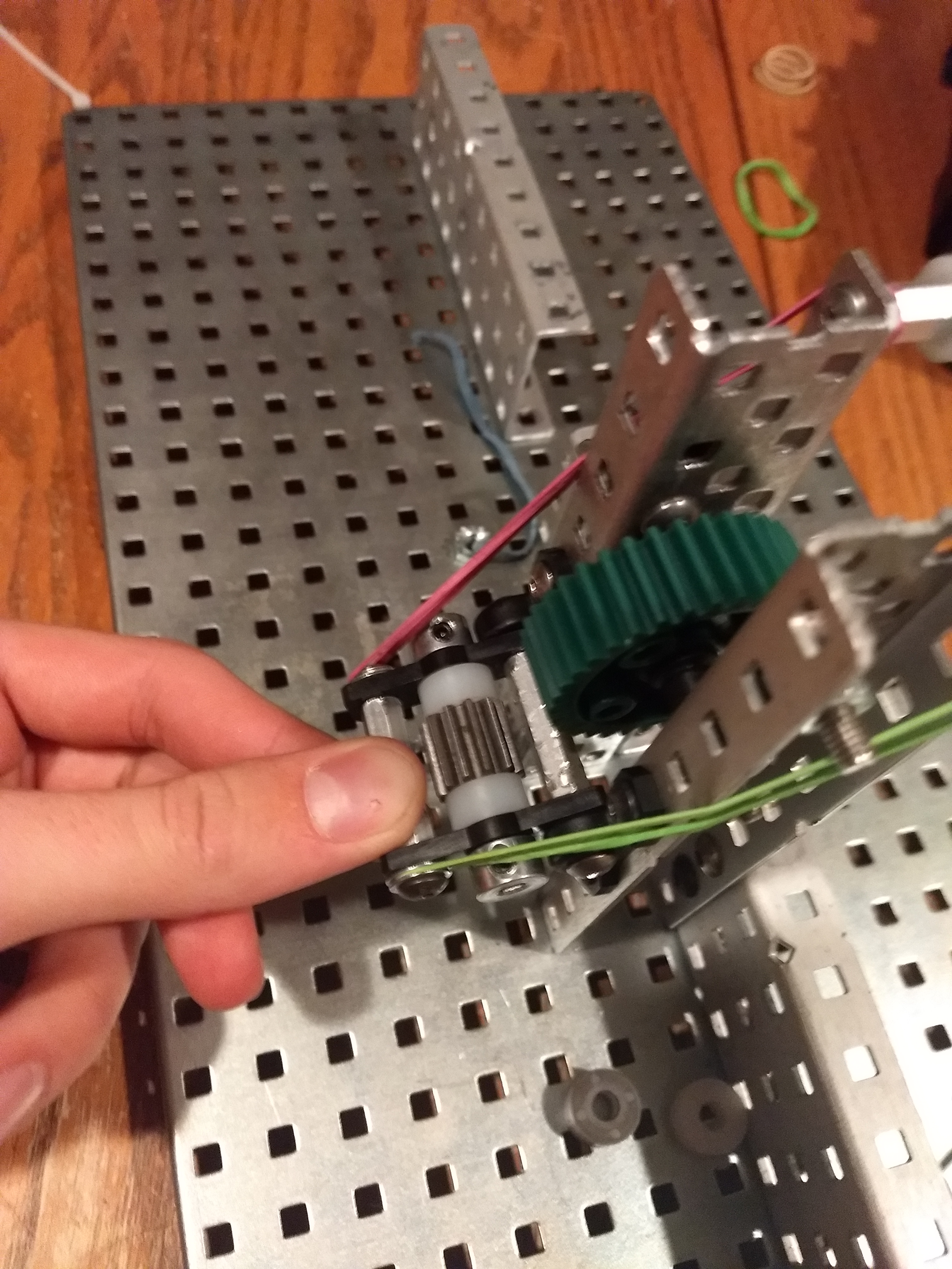

Thanks, I got one that works now. Was easier than I thought it was. These are the pictures of what I ended up doing. If you guys have any feed back that would be great
#8
don’t quite see how that’ll hold the shaft in place, or make it only go one way.
