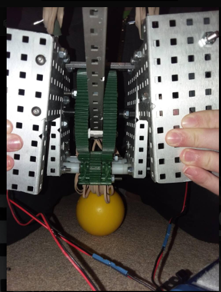

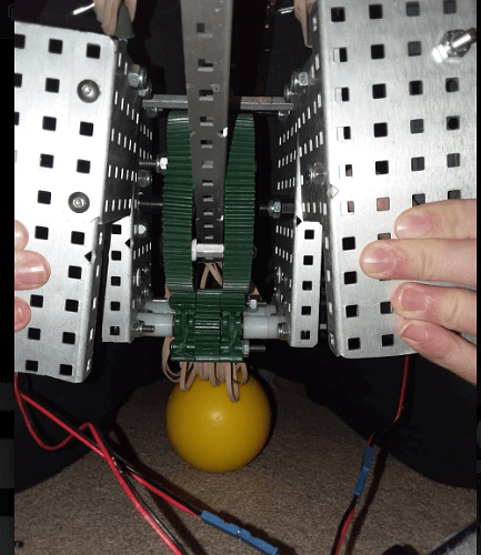

I need help our catapult skips.I change the rubber band place and i change but can not get a lot of power
Can you clarify what exactly skips? The gear over the rail or could the rail be hitting something else?
Did you try to add more rubber bands?
Chances are that the axels aren’t properly supported. Do you have pics?
I can give you some. If i add more rubber bands it skips gear. but if it has less it works but not a lot of power
i will get a video
Make sure all of your bushings are tightly secured to the bars if one slips it could be causing the gears to not mesh properly. Also if you are not using high strength axils I would recommend pulling them out to see if they are bending. Lastly, make sure that the space between the two bars that hold your catapult arm/gear is as small as possible. This will reduce the axils flex and help the axils mesh better.

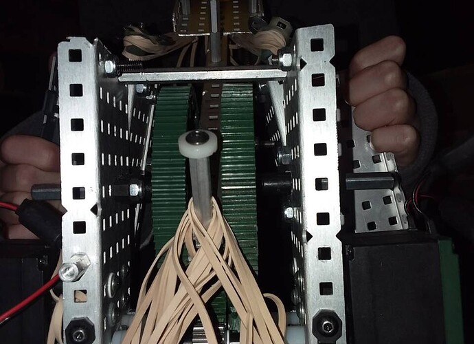

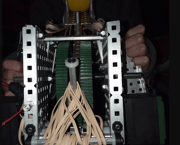

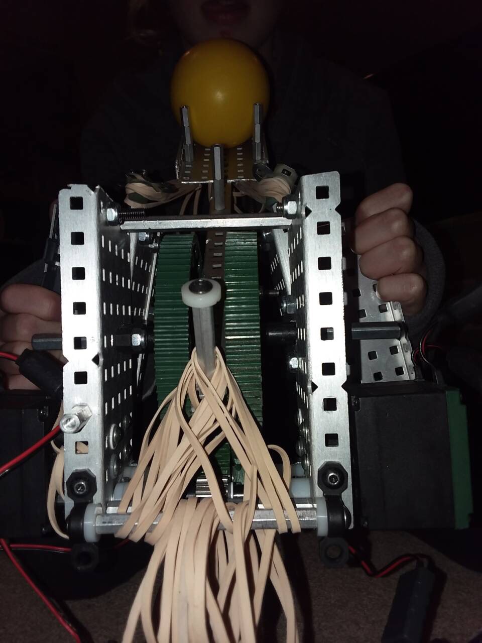

using high strength shafts would probably fix your problems
we have high strength on the big gears
another one
try using HS shafts on all the gears you can
