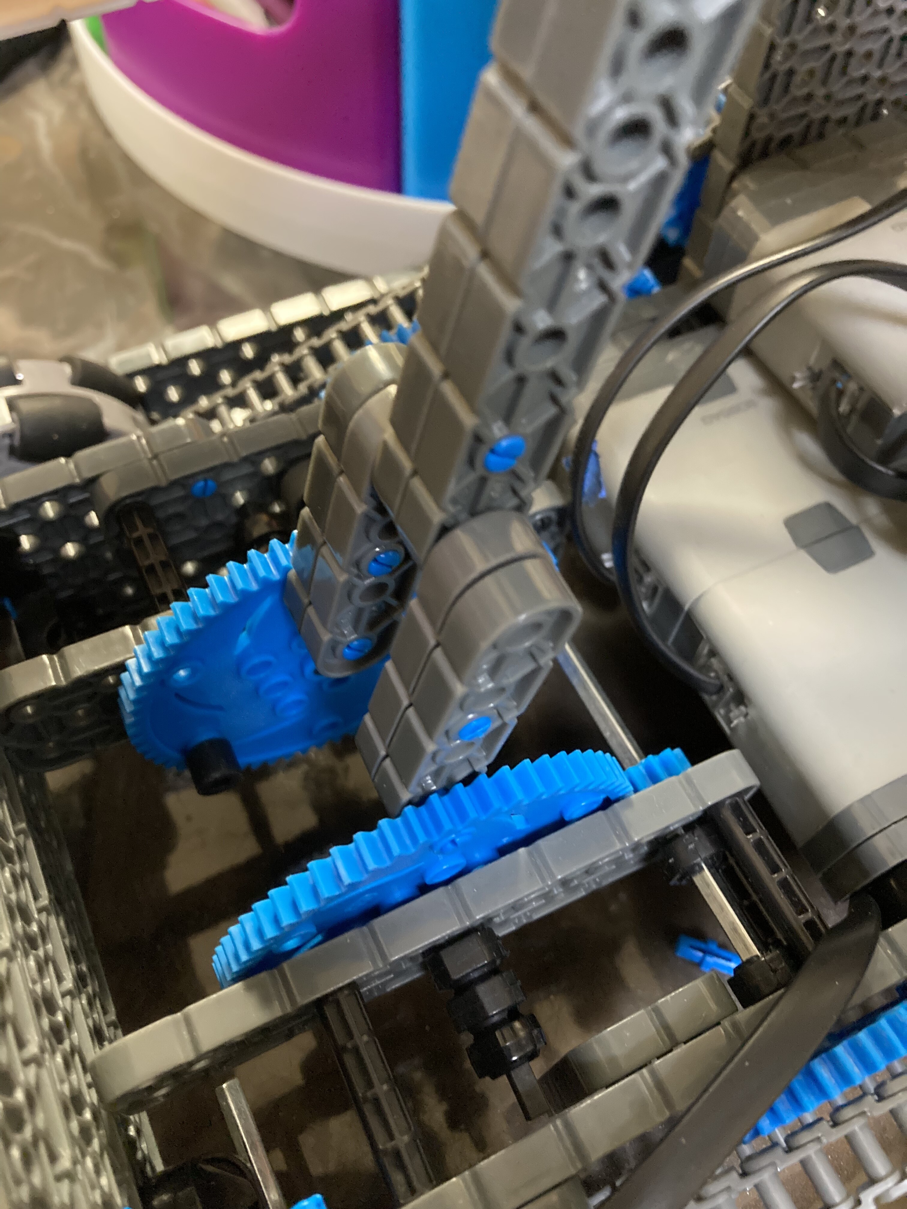

Can you share any images of this catapult? It would be much easier to help you if we knew what your design looks like
Sure I will get them as soon as I can
The catapult choo-choo mechanism
How/where does it break

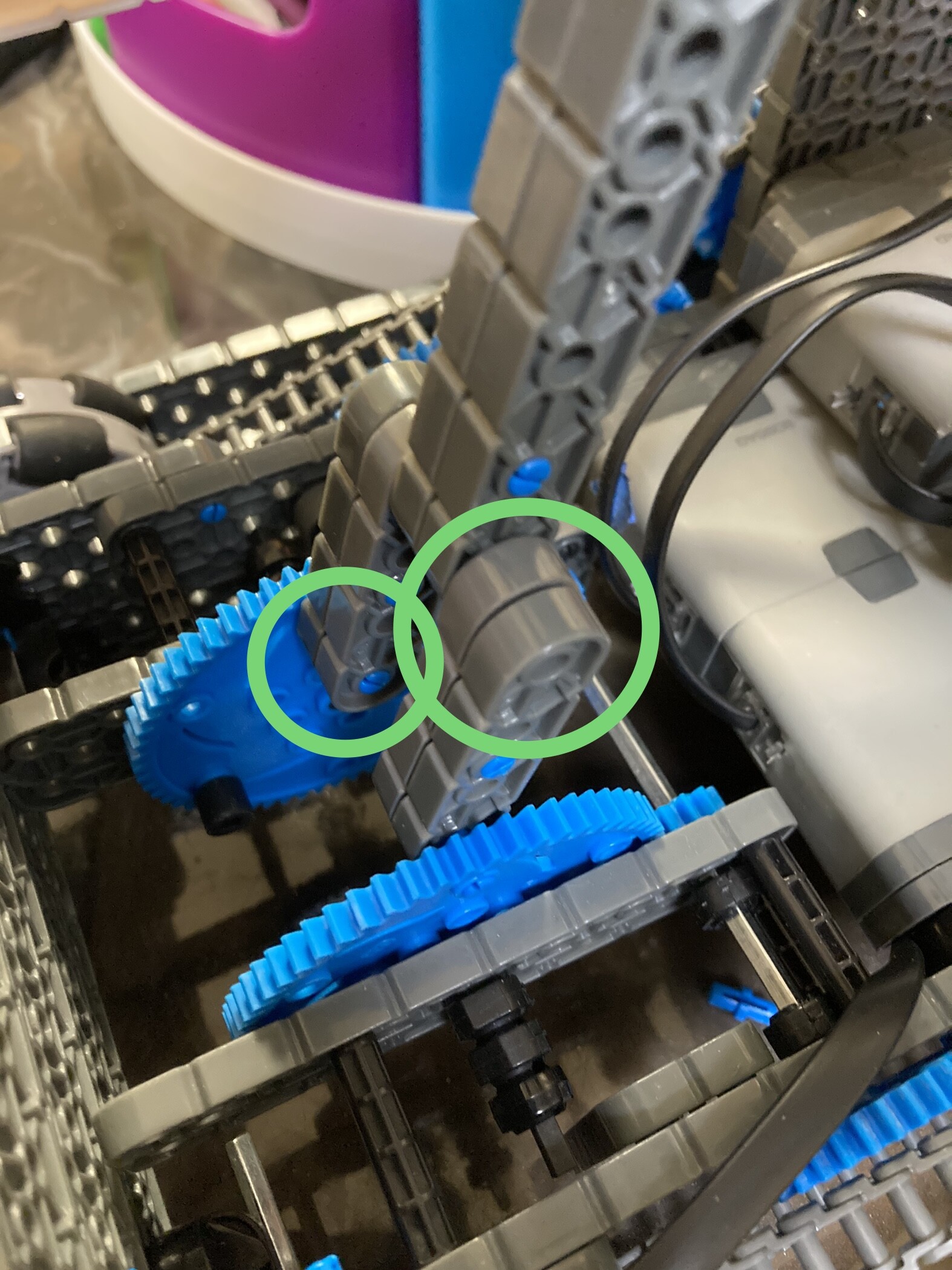

@7996B It brakes in the two green circles
@7996B and @Derek would any other pictures of other parts of the catapult help?
Use the 0x3 nails and put them in so it would have to come through both beams to break.

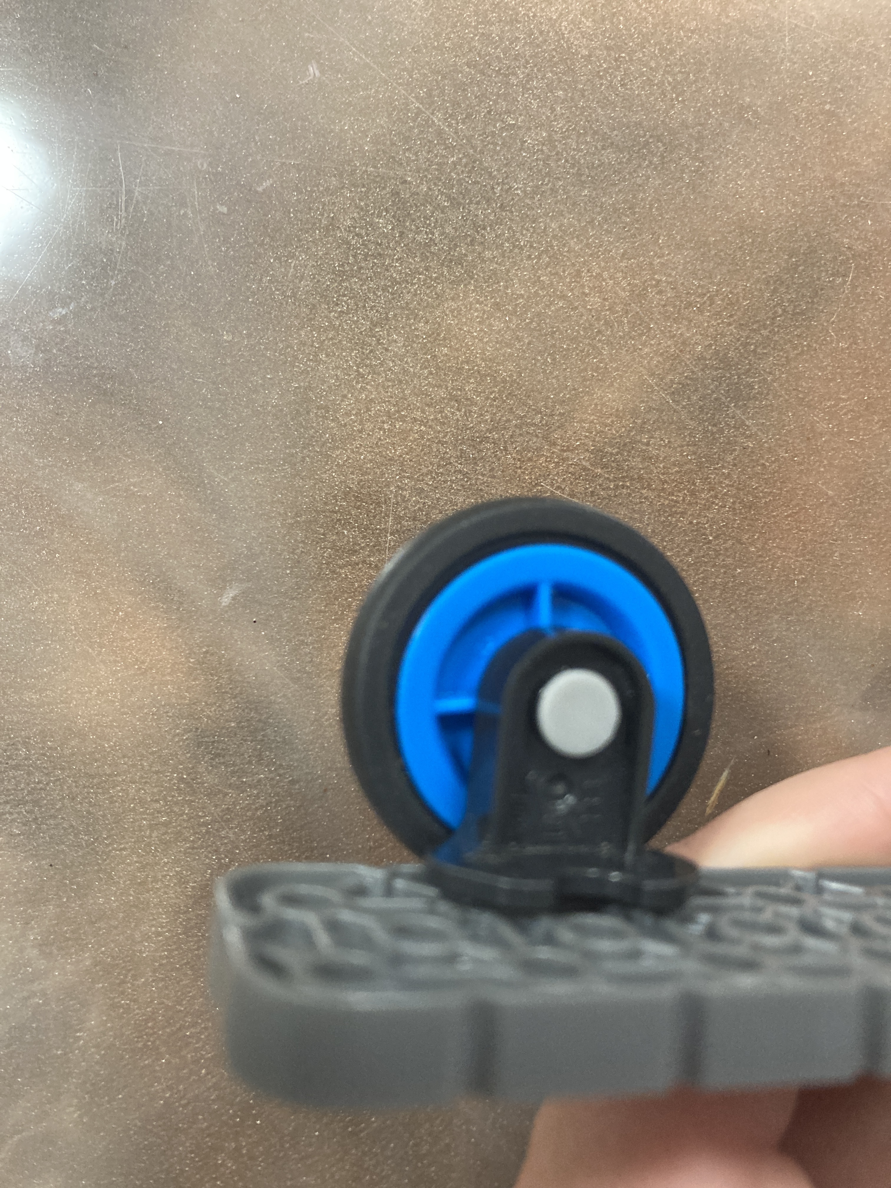

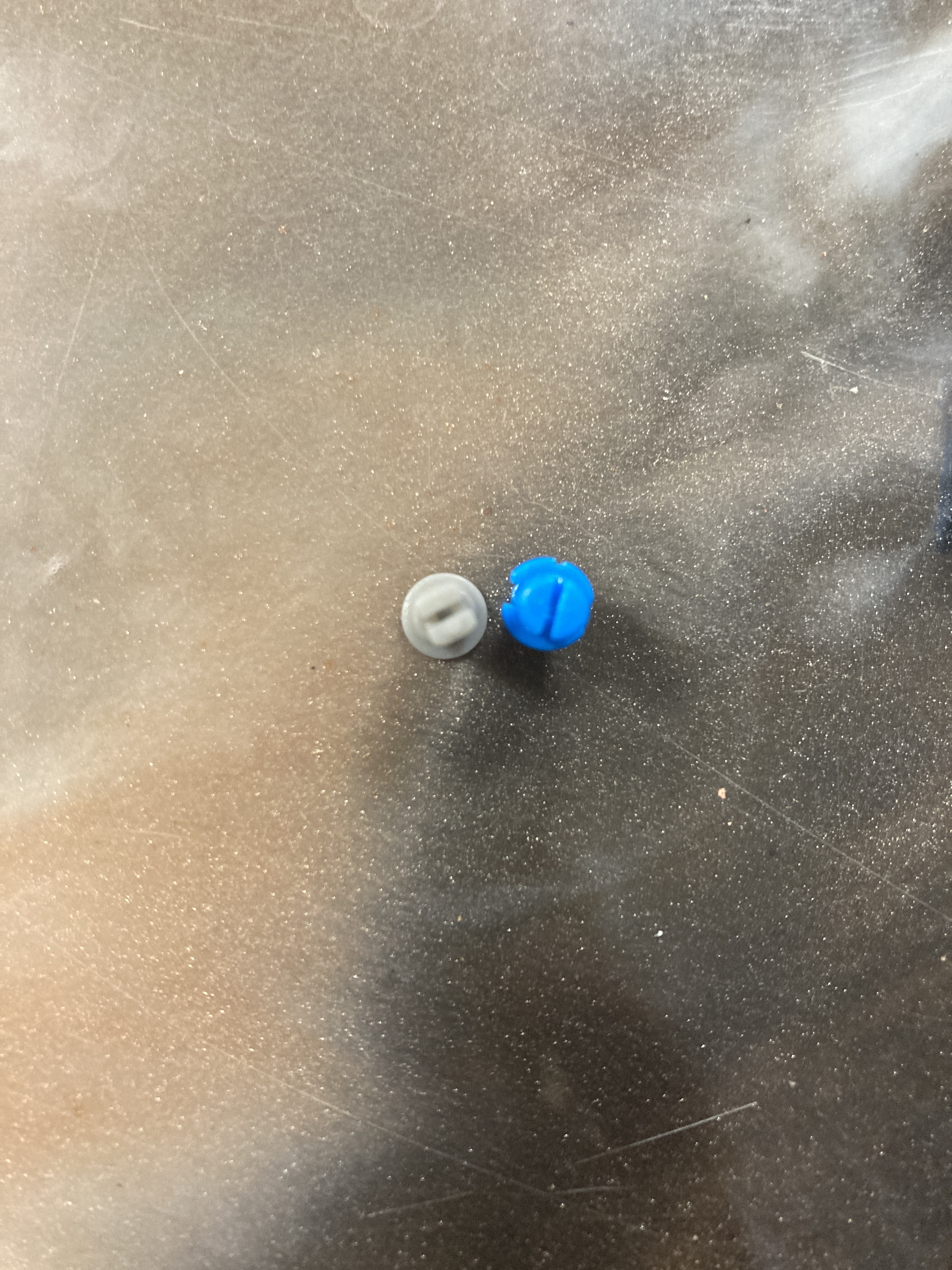

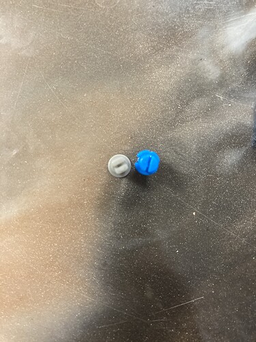

I don’t have any 0x3 nails all I have for a nail is the grey but it is Meant for attaching a pice to a wheel like this⬇️
And it is square at the end unlike the blue one beside it

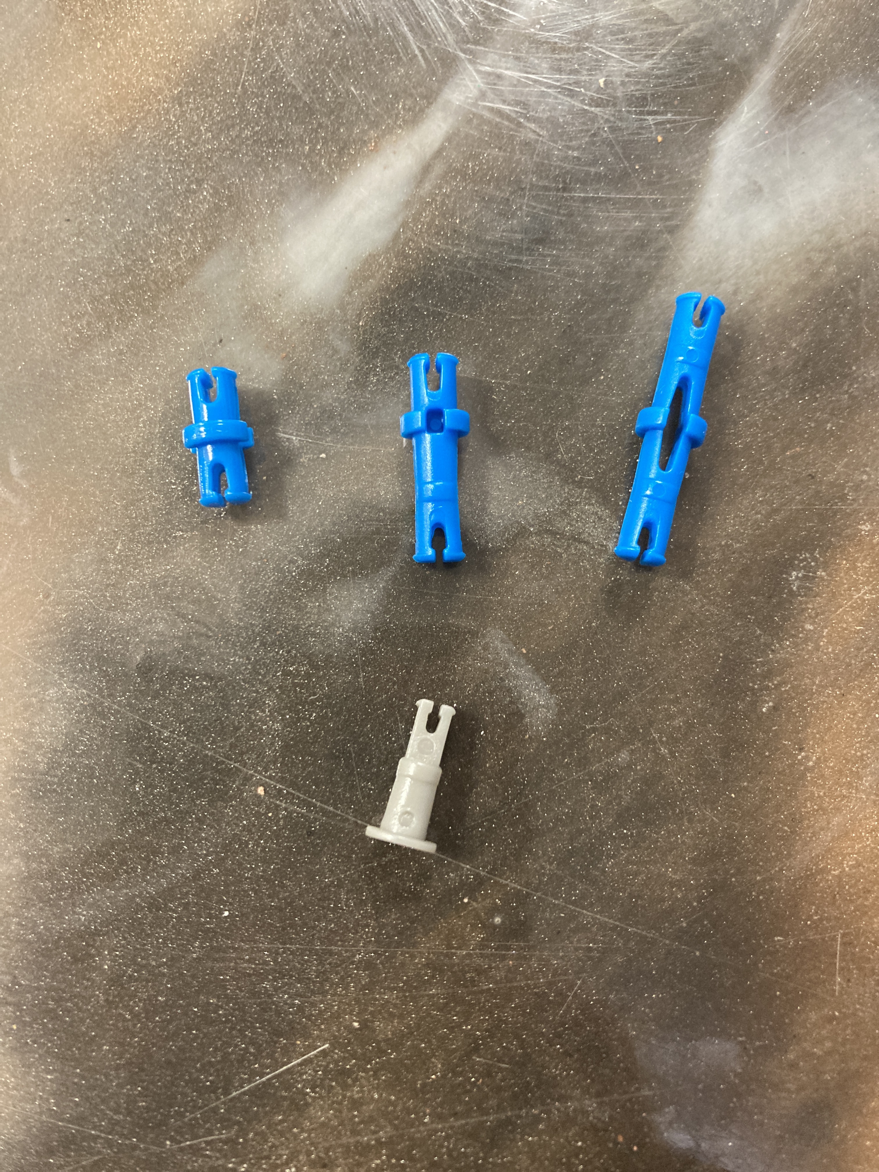

But I also have the blue pegs that have no cap on the end
If you have the Pitching In field, if you look at the bottom corners of the plastic sheet, you will find some 0x3 pins in the orange pieces.
