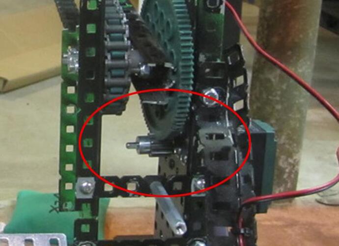

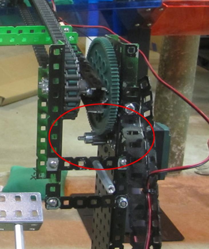

We have the chain bar working on a 7:1 ratio. We also have the intake attached. It can lift 4 sacks pretty easily, but we are trying to lift more.
Here are a few pics that way you can see our setup to better help us!
http://team323z.weebly.com/uploads/1/0/0/6/10062475/2788686_orig.jpg
http://team323z.weebly.com/uploads/1/0/0/6/10062475/5422951_orig.jpg
http://team323z.weebly.com/uploads/1/0/0/6/10062475/891567_orig.jpg
http://team323z.weebly.com/uploads/1/0/0/6/10062475/5066763_orig.jpg
Looks good!
If you want to lift more sacks you will either have to allocate more motors to the lift, make a compound gear ratio, or figure out how to put elastic on the chain bar.
Do you have any problems with sacks getting caught in the intake?
Thanks. That is what this thread is about.
What is the best way to use elastics. I got a good idea from team 1024. Any others are appreciated!
No. We have had NO problems with sacks catching in our intake.
I’m surprised this is not giving you issues. The axle needs support through two bearing flats. It looks like it is just cantilevered through the C channel, or is there some other structure I can’t see.
[ATTACH]6817[/ATTACH]
It has given NO problems what-so ever. We did not have enough length to get all the way across, but I just picked up some longer axles from Team 1024! Thanks guys!
We will be adding longer axles next meeting.
