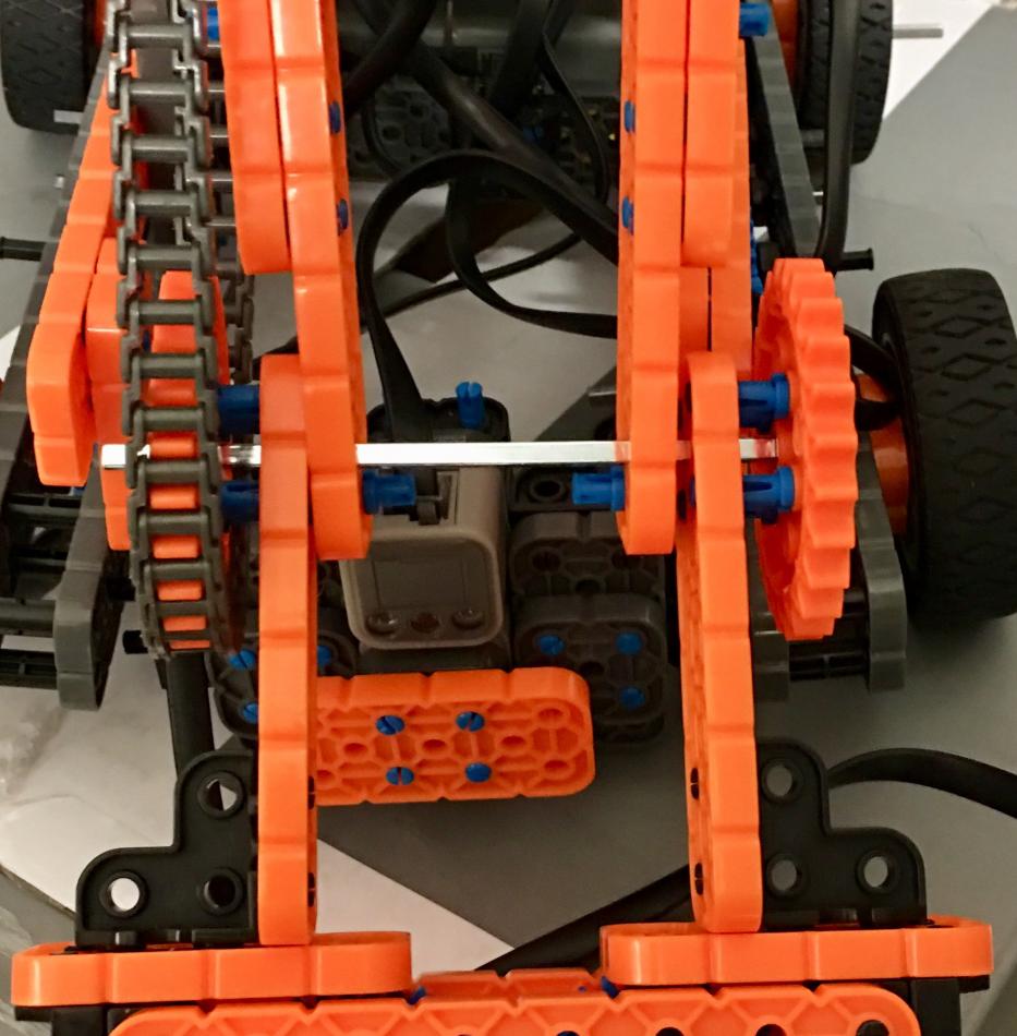

Has anyone built a chain bar lift in IQ? We are trying but cat get it to work right. * I guess it really should be called a chain bar linkage.
Can you post a picture of what you have so far?

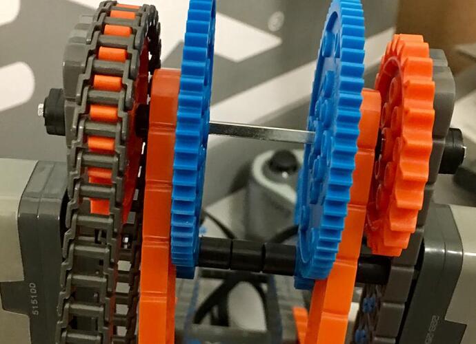

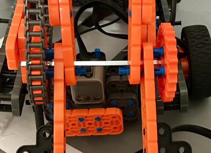

The one with the blue gear is the top of the arm, the other is the bottom of the arm. We want it to hold the claw parallel to the floor when we move the arm up and down. It doesn’t right now. The claw doesn’t rotate to stay parallel when we go up.
The sprocket at the top needs to be fixed so it can’t rotate. In IQ, this has to be done slightly differently to in VRC since in IQ, you are not permitted to drill the square drive out of the sprocket. I’ll post a pic shortly.

That’s it! We have the axle going thru the top sprocket! Thanks for your help!
