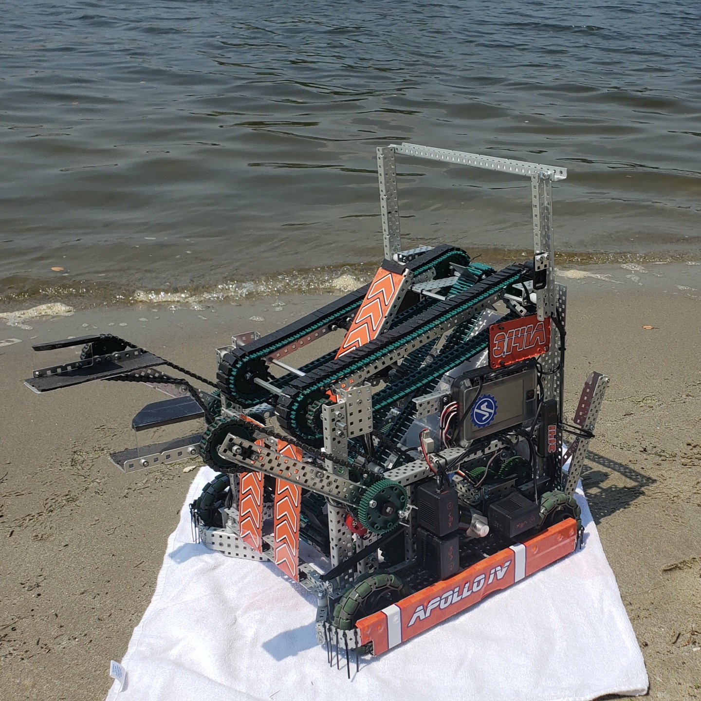

I’ll be building a second robot with a chain bar to try it out. I don’t plan on making the holder on top though. Hopefully nobody on Northern New York is reading this.

My team opted for a chain bar lift this year, and we went through how it works in our notebook. The pressure on the chain is minimal, and really only apparent when you put in a bunch of tensioners. Otherwise, the driving sprocket is rotating, and if built correctly, the bar is simply staying parallel, and the angle is increasing in a linear fashion.
I’ve found this to be extremely helpful when you need to lift a goal a certain amount, specifically for the platform. You can simply tell your driving motor(motors, in my case) to turn X amount of degrees, and it will rise to a certain amount.
