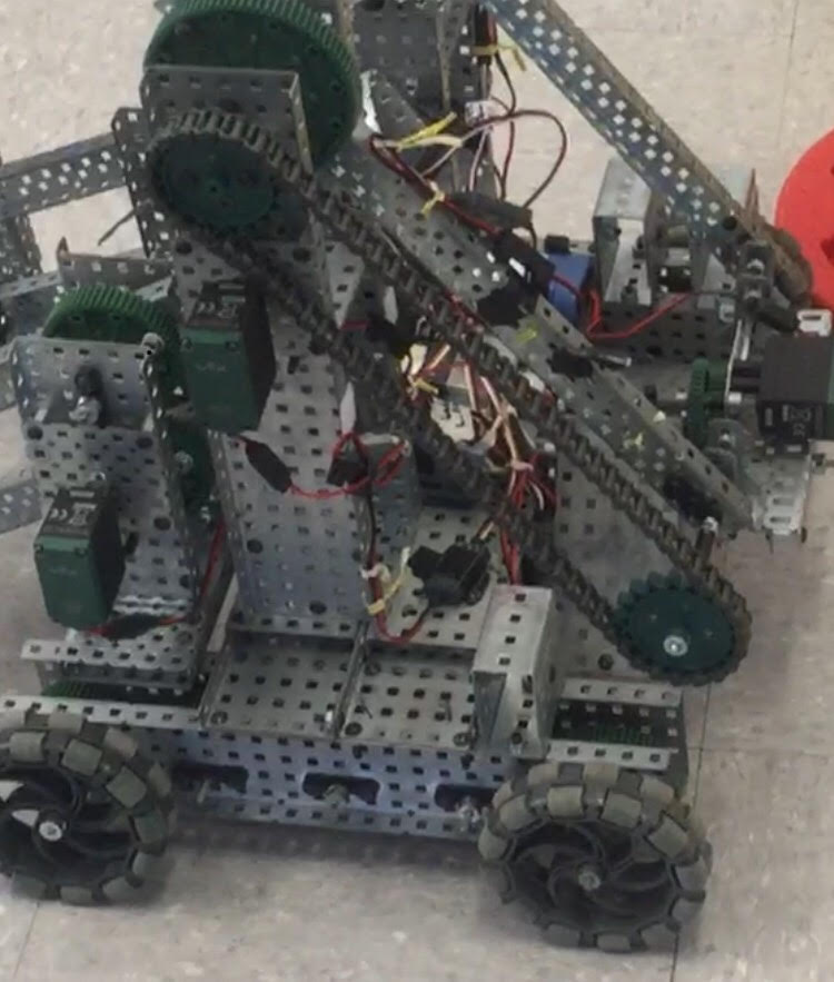

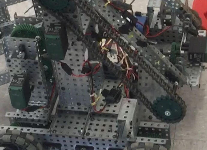

So recently on our robot we are trying to make our arm go backwards, but it does go backward and doesn’t go back. We have tried to put a chain drive on one arm but it still does not go back to it’s OG spot. If anyone knows how to solve this problem please tell me. Thank You!
Sounds like a mechanical problem, sending pictures will help us to help you
The chain drive right there is the only one we have attached. When we move it back it gets stuck and won’t go foward again.
If anyone has suggestions don’t hesitate to respond, all ideas are great ideas :slight_smile:
Make sure the bars aren’t hitting anything when it moves.
Nothing is hitting it. Do you think another chain drive would help?
Oh, well yes. You should never use just one, but that will not solve your issue. Try to take apart the motor and see that all the internal gears are ok.
Will do, Thank you so much
