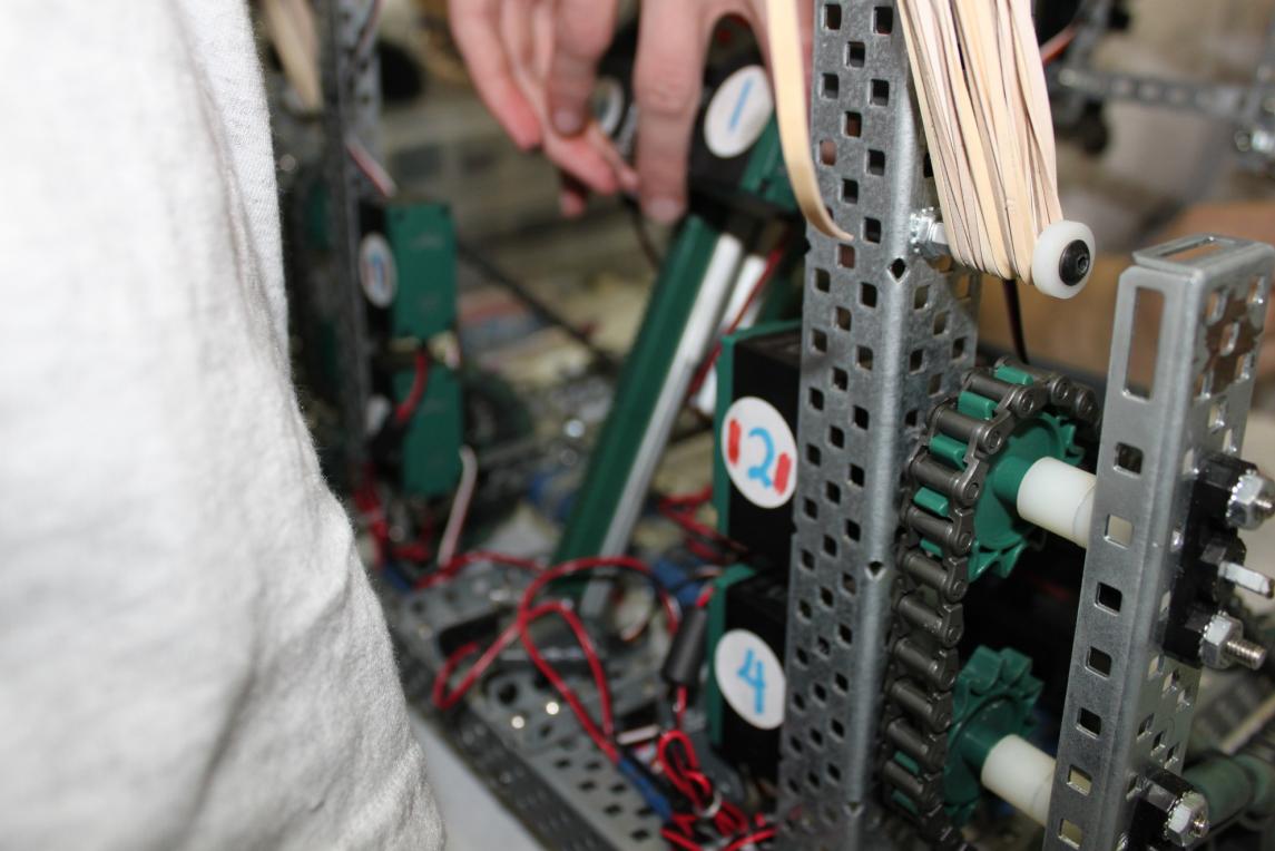

Interesting. So the motors, which are running the base with the chain are under the base? Thats pretty interesting. in addition to that, you are using 6 motors… Hmm. Ill post a picture of one of my brother team’s robot. Sorry if you cant see it that clearly.
Look more carefully.
The wheel chain drive motors are not under the base.
The 6 motors that you can see ARE the wheel drive motors.
Thats the “cluster of motors near the back,” that I mentioned.
Rick’s picture is of the back of the robot, not the bottom.
There is another motor on each side, (behind the C channel near the UltraSound) that operate the arm.
That makes 8 motors you can see.
There are probably two more motors on the intake roller in the front, that you cant see from this angle.

We should have pictures of it, but I’m not sure where they are… I’ll ask around on my team and see if I can find them. But I’m pretty sure that it was 1:3 on HS chain with 1 LS motor and 1 HS motor on each side. The motors may have been geared together with 36t HS gears and then chained, but I am not sure… We built maybe 10 drive bases for the same type of robot design, so my memories of them kinda all fade together…
Edit:
I found a couple pictures that show the drive base:
And bigger versions are at:
https://vexforum.com/gallery/showimage.php?i=5269&c=8
https://vexforum.com/gallery/showimage.php?i=5266&c=8
How many motors are you using on the base? it seems as though 6?
There are six, i really think that going any less is a bad idea this year, at least for an interaction robot
we usually have all 4 HS on our drive (internal gearing 1.6:1)
that provides us with speed as well as power
and that would also simplify the drive chain (6:6) because the motors are all the same kind
