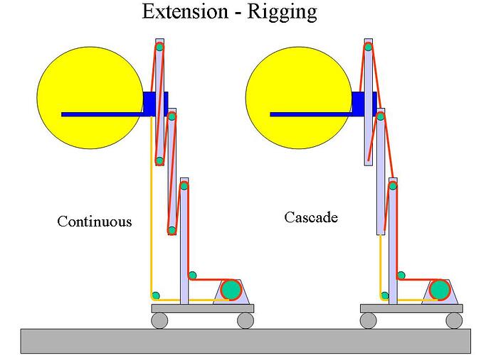

What would be the best design for a chain elevator system for an arm? I don’t know very much about chain systems, but I have seen it used often in the FIRST Tech Challenge. Also what is the average height that a chain driven raising system can raise to. :confused:

Important Considerations when Building a Chain Lift:
[LIST]
*]The Vex chain is made of plastic, and has a limited tensile strength. (If you pull on it too hard, it will snap.)
*]Using 2-chains in parallel means that each chain shares 1/2 the load. Using 3-chains in parallel means that each chain shares 1/3 the load. Etc… etc…
*]Vex Tank-Tread can be used as a “high strength” chain. It has a much higher tensile strength than the Vex Chain. (You can even cut off the tips of each tread-link to make it more compact.)
*]There are many different types of cable routing for lifts, see attached image for 2 common types.
*]The weight of the extension, as well as any friction in the system will be placed upon the motor as load. This load will also be placed upon the chain. Can it handle this load?
*]If the extension “jams” then the full stall-torque of the motor will be run through the chain. Can it handle this load?
*]Vex Linear Slides work best if left “a little loose”. If you use 2 of them together in parallel, and they are very rigidly placed, there is a chance that they will jam if they are not perfectly in allignment.[/LIST]These are just a few thoughts which popped into my head. I have every confidence that you will be able to accomplish your goal. My experience with the Vex system tells me that this design will be successful for you.
