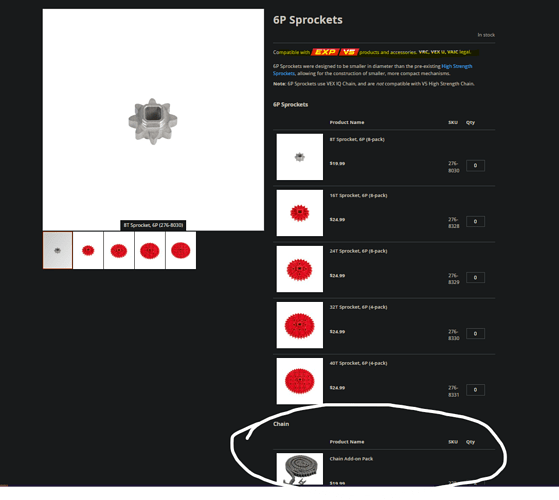

We ran into a hiccup with the 6P chain during inspection this weekend. The inspector rightly identified the chain as Vex IQ and questioned the legality. The team was able to convince him that since the 6P gears are legal so is the chain even though the product page for the chain ( Chain & Sprocket Kit - VEX Robotics ) does not explicitly say that, nor does the product page for the VRC 6P gears ( 6P Sprockets - VEX Robotics ) since the 6P chain itself is not listed there. @DRow - is this an oversight that you are able to address by updating the 6P-sprocket page?
does the chain add on kit count? it’s listed under the 6P sprocket page, and has the tag that declares it as VRC legal.
That worries me, since my team’s drivetrain has the smallest size of sprocket on every wheel. oops…
Though it hasn’t broken before, somehow.
As @Benn alluded to above, there is no specific “6P Chain”. It’s simply the same chain used in VEX IQ.
As the VEX IQ SKU is listed on the 6P sprockets page, it is legal for use.
