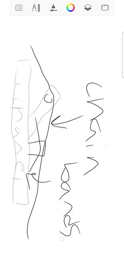

No, but I’ve seen a team do it in turning point. I’ll draw a quick pic to illustrate it.
I drew this on my phone, so it isn’t the best
Screenshot_20190828-155715_Autodesk%20SketchBook
it really hard to depict, maybe if you have a physical example take a picture.

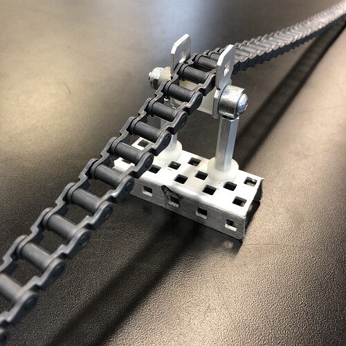

I made something like it what @Railgunawesome is describing, but it is probably not the ideal tensioner, a nylon space on a screw or a idler sprocket would work better.
Yes, somewhere along the lines of gameoa but more like a c channel with a spacer for the chain to run over. The c channel would be attached via axle or screw joint to the chassis. The rubber bands would be attached to it similar to how the tray foldout is setup. The c channel would rotate and thus tension the chain, and would be pushed down when the chain tightened, ie when. Your bot starts moving.
You could also use what @Gameoa has shown, but mount the sprocket on a c channel or piece of metal, then use rubber bands to push the sprocket down.

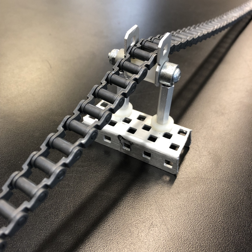

I know I posted a picture of a simple tensioner a while ago. Let me see if I can find it.
This tensioner isn’t on a robot (obviously), but it shows the idea of using a spacer rather than a sprocket. When trying to compact a tensioner using sprockets, you’d likely end up with a 6 tooth sprocket, which are if I remember correctly are notorious for breaking chain. A nylon spacer does a better job without even having to rotate. Just let the chain run over it and the smooth surface should take care of the rest. :​)
