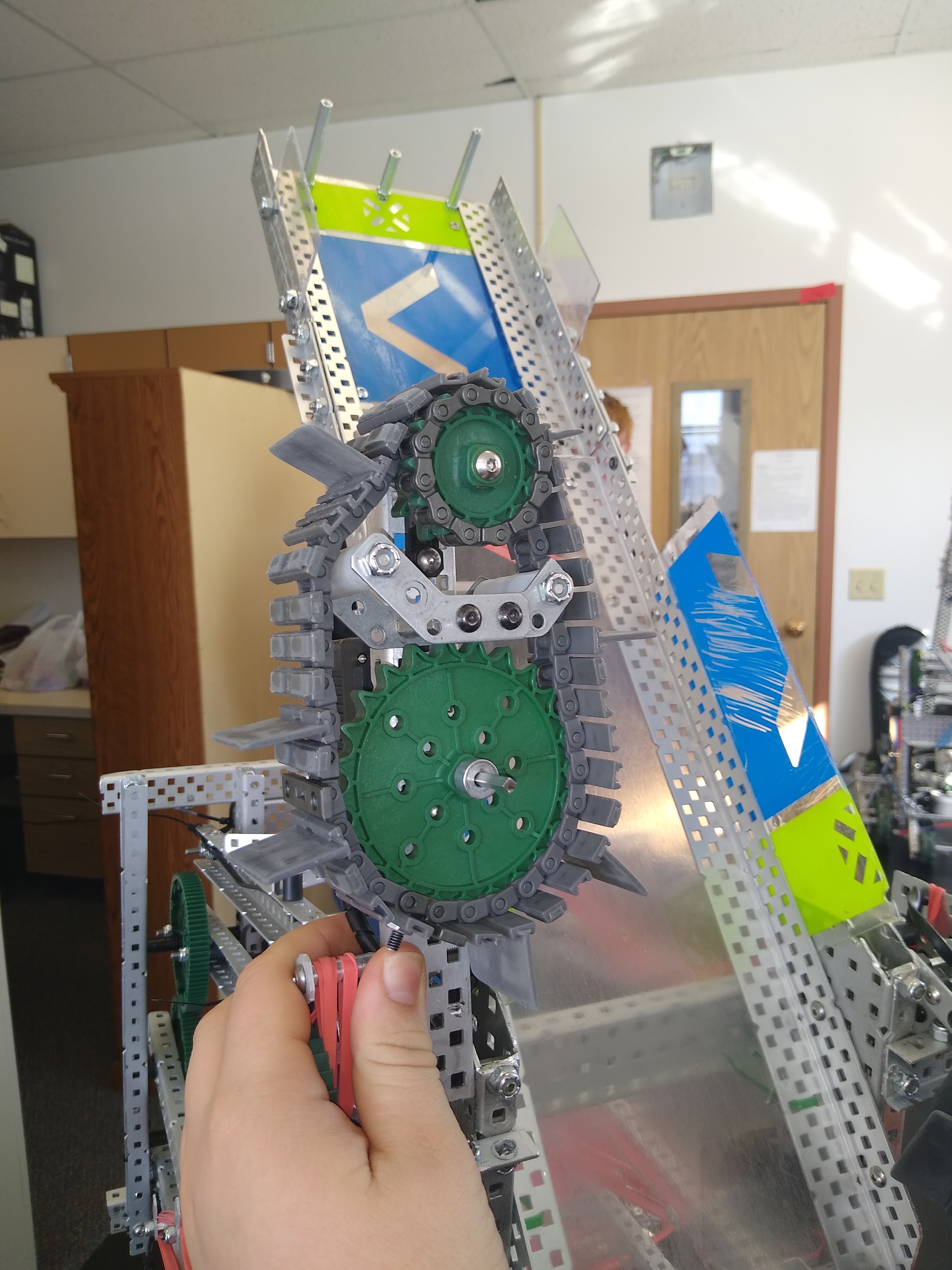

Hey guys,
Our team has had a ton of trouble with out intakes. Our chain is continuously snapping off when we intake a few cubes. Were not sure if its getting caught on something, which doesnt seem to be the matter, or if there is another cause. If this has happened to anyone else and you found a solution please share your findings with us!
Also, we’ve been struggling with tension and our intakes. Is there any way to release tension when stacking yet still have it while in taking?

Not sure if this will help but you never know
You could put the intakes on coast while stacking so the chain moves. But for the breaking part. do what @Ciaran-N said and make sure that the drive shaft isnt getting held or stopped by like a rubber band getting caught in your intakes and stuff. You might have to much compression.
I believe that the problem is unequal spacing. Check to see if you have the exact number and size of spacers on the front and back sprockets.

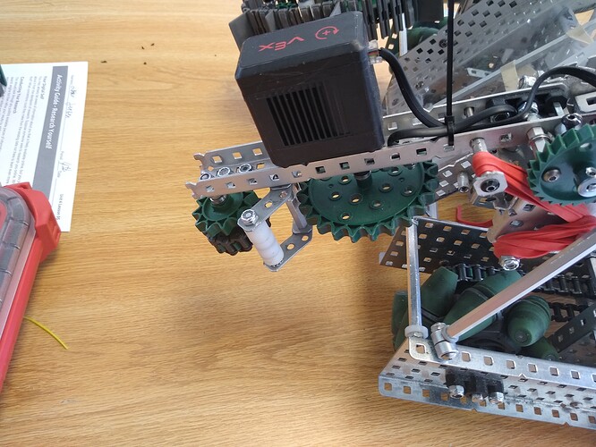

@kmaster is right. For us, our sprockets would slide down a bit and that caused the chains to slip off. We solved that problem by threading our axles. But we recently just changed the conveyer belt pieces with the actual chains since they don’t loosen at the joints as easily. Also to maintain compression while being able to have your intake move out of the way can be accomplished by a hinge and rubber bands.

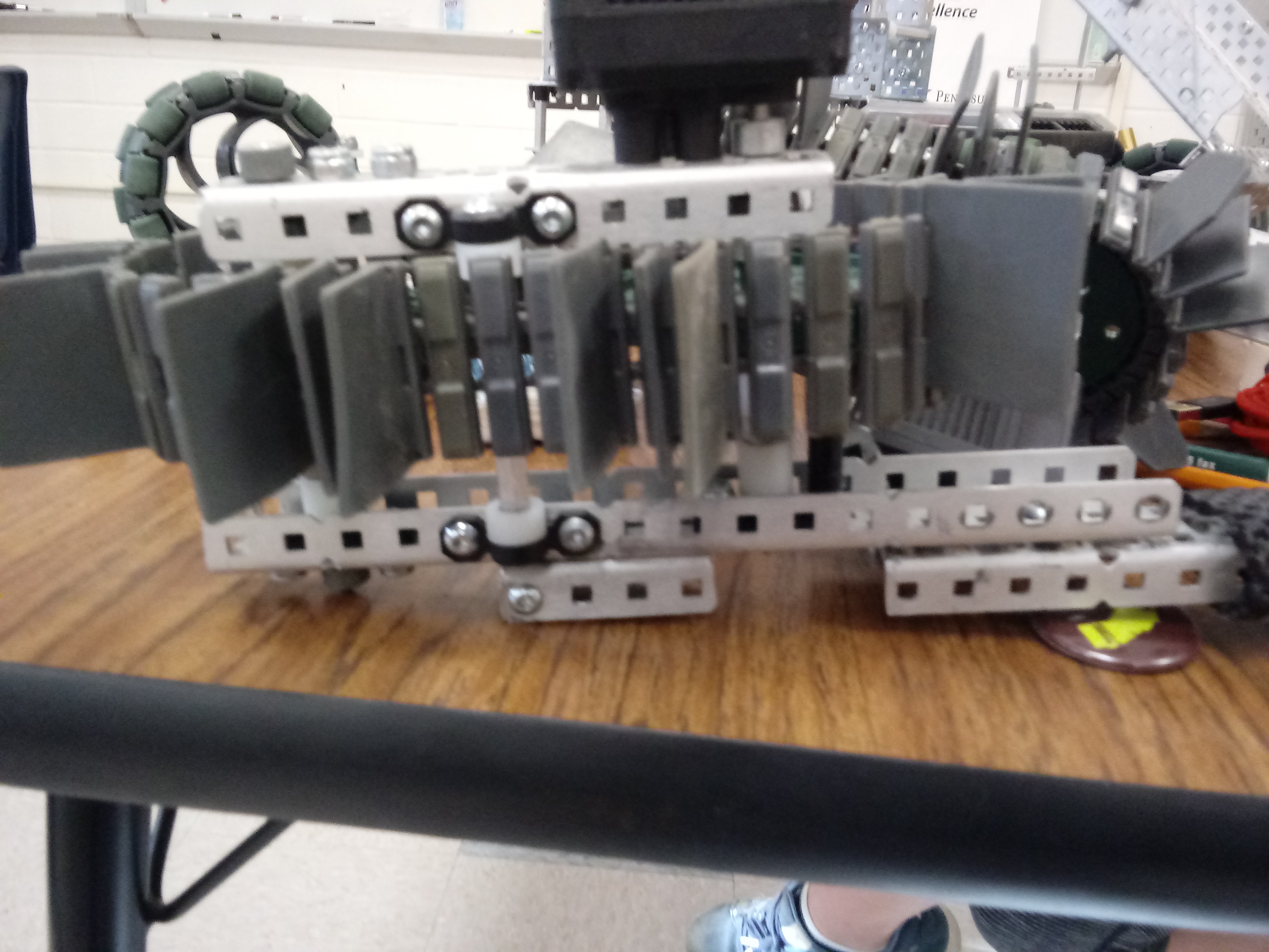

We have had a problem with our intake as well but while we were at Night At The Museum we noticed that a lot of the teams of a “Reinforced” intake of sorts. The intake would have the main chain with the rubber tread and flaps sandwiched between two sprockets with drive chain. It was too big for our robot so we just used one row of drive chain. This has worked very well for us. If that made sense.

Our’s snapped off too but I think it was because they began to slip then tilted at an angle and that caused it to snap off

This one above is without the upper chain.
The one below is with it all together.
If you need anything else let me know. I hope this helps.
