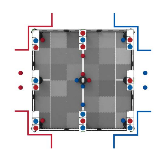

“Quoting” appendix A with a screen snip:

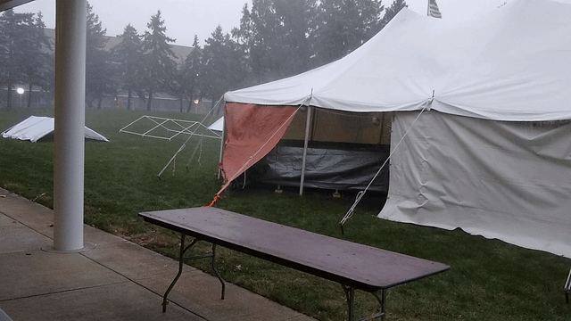

we can see that no dimensions are provided (therefore telling us that the exact dimension are not regulated by the manual). Many events, for example, an outside event played on a grassy lawn, do not have alliance station markings on the ground, as the tape doesn’t stick well to grass, especially in the rain:

What we can tell from the appendix and it’s image is that the Alliance Stations are at the corners of the field, to help with social distancing, and extend roughly 2’ from each corner. The scoring referees (based on my experience) stand where the driver interface connection is, and generally need to remind drivers to stay near the corners for appropriate social distancing.
I sat down with the official printout of the game floor (the one posted above), and took a close look at the relative spacings, alignments, size of the game floor tiles, and so on, and decided that it looks like the edge of the colored tape that is nearest to the game floor perimeter is roughly six inches away, so that’s what I did. My tape lines that are parallel to the game floor sides are six inches back from the outer edge of the walls. As you look at this picture, the right edge of the blue tape that is in line with the white tape on the game floor is aligned with the left edge of the white tape, and that is mirrored with the red. The blue strip that is perpendicular to the white tape strip is placed so that the left edge of the blue tape (as you face the game floor) is aligned with the right edge of the connectors on the two floor tiles, again, mirrored on the red side.
