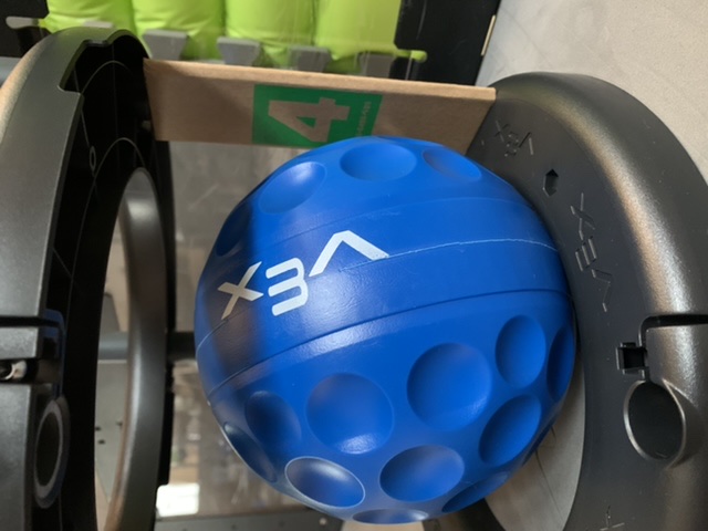

Hey everyone,
We have the new field assembled. The balls are a tight fit exiting between the base and #2 ring. Appendix A shows a 3/100" clearance. I know that yes, it’s +/- .1".
I also show the cardboard spacer for the bottom (critical) space to be 1-2 hundredths short according to a caliper reading.
Is it the overall intention for the balls the ‘scrub’ and be tight exiting the bottom of the ring assembly?
Inconsistent ring spacing (and thereby friction) is going to GREATLY complicate competing on new fields other than your own.
Yes, this is the case. The goals are flexible to allow balls to come out, albeit with a bit of effort.
Most likely not, as robots will be designed to be able to remove balls from goals.
We’ve got a properly-spaced ring assembly, verified with appendix A specs and a caliper (that I know how to use). The balls are so tight that you can’t remove them BY HAND unless it’s straight outward… they will not exit ‘sideways’.
I found assembling and installing the goals extremely frustrating. Even among the ones I constructed, there is definitely variance in how much force it takes to remove a ball. Admittedly, I did not use calipers
I’ve kept the official cardboard spacers; definitely intend to pack those for each competition we attend just in case. Though, it seems likely that even the spacers themselves could have variations between them, and, being cardboard, are compressible. Ran into variance between sizing tools last year to our chagrin.
Seems like the best assumption might be to have a goal at each end of the spectrum - extremely loose and extremely tight - and make sure you test against each.

Per appendix A there is 3/100" of an inch clearance. However, we are seeing ZERO clearance… I guess it’s due to the balls being larger than spec. In addition, the rings ‘droop’ a little. So proper spacing at the back (where the poles are) leads to IMproper spacing at the front (where the balls will exit).

Could you explain where you are getting this number from? According to appendix A, the clearance is actually -0.17" (4.318 mm).

2775, yes. I can’t find my 6.1" dia I thought I saw. We are undersized by .17". Even nastier…
We took some of last year’s plastic dowels and have cut them to precisely 6.13". They will be traveling with us to competitions.

The balls definitely hit the lowest elevated ring when being descored
