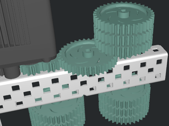

would this ratio work with a 200 rpm?
(the three motors together = a sprocket and flaps. the bottom pair is connected by chain an flap.)
if you want a good ratio using 200 rpm cartridges, use chain to get a 1:2 ratio for speed. 6t sprocket to 12t sprocket, or 12t to 24t. or just direct drive, tbh 200 rpm is still fast.
ok. i will try this. thanks!
