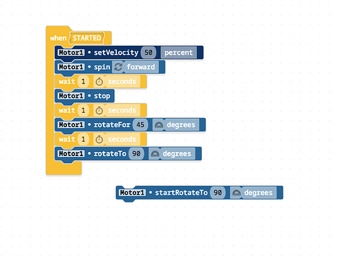

As most of you know, when the V5 system was released VEX provided a programming environment called Vex Coding Studio. The roots of VCS were in an older environment that was only available for VEX IQ called Modkit, a blocks only environment that was first available in 2013 (or about that time). For those who have never programmed using Modkit, a sequence of blocks with some motor commands looks like this.
Notice that the commands use “spin” and are somewhat similar to what we have today in VEXcode.

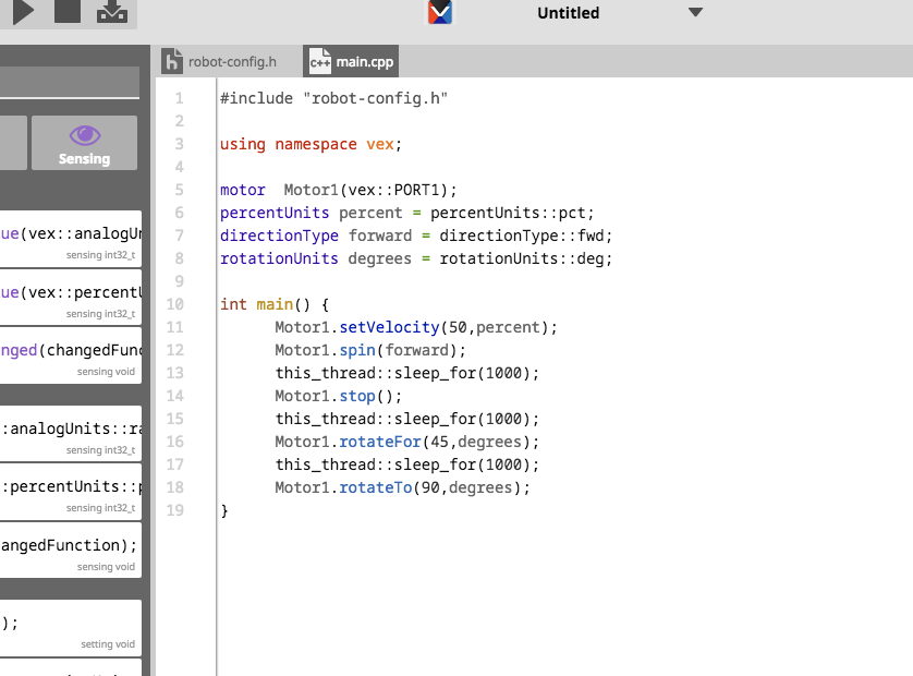

When VCS was created, there was a thought that “spin” should be kept for unlimited motor movement and “rotate” should be used for commands that would cause a motor to go to a given position.
Similar code in VCS would look like this.
Block code in VCS had the limitation that it could not handle optional parameters, so it wasn’t possible to have the “and don’t wait” option we have in VEXcode on some of the motor blocks. The only solution was to have an alternate block, and hence C++ API, called startRotate that would have that functionality.
The VCS blocks above when converted to text looked like this.
That was where we were in mid 2018 when VCS was being used.
