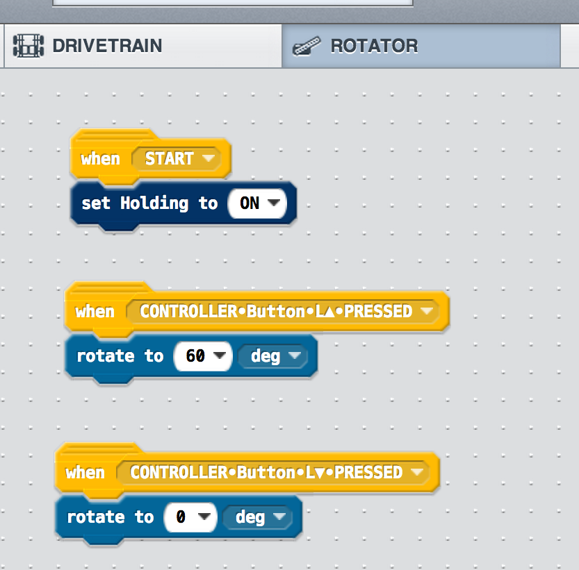

I would recommend using a Rotator in Modkit for the lift, not just a plain old motor. With a rotator you can add a second motor and ModKit will keep them in sync. In this first sample there are two pre-set positions for the lift, up and down, and the left buttons control it. L-Up goes to 60 degrees, and L-Down goes to 0. The user does not need to hold the button down, just press it once and it will go to the preset position. Note that the Holding is set to ON. If you don’t set holding on then the dumper will go to 60 degrees and then slowly fall back down.

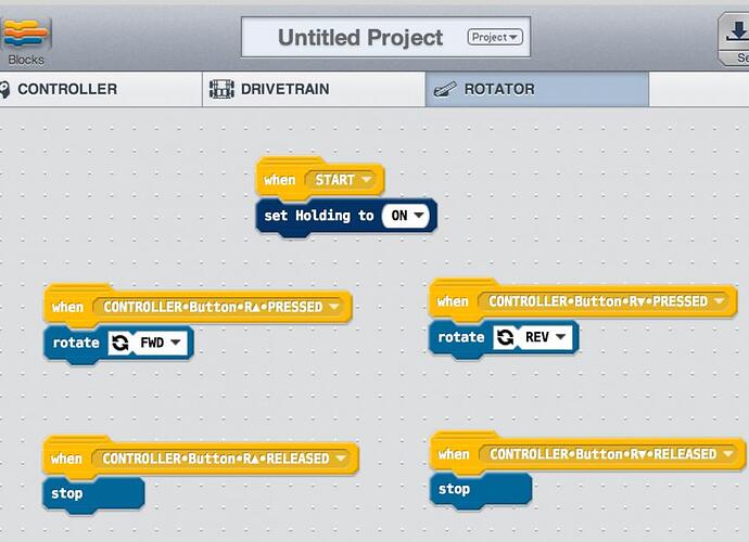

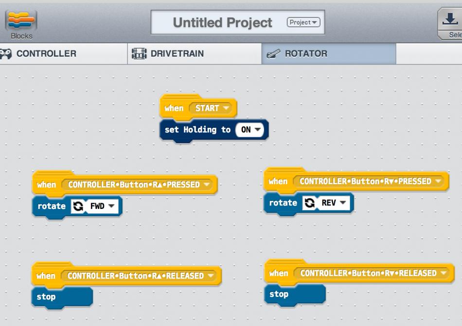

The second sample is for a manual mode and uses two buttons to go up and down, but it does not use pre-sets. When the user is holding the R-Up button the lift moves up. It stops moving as soon as the user stops pressing the button. The R-Down button goes in the opposite direction. Note that there are separate events for pressing the button and letting it go. If you didn’t have the STOP block when the button is Released, then the motor would keep going until it got stuck or ripped the lift apart.

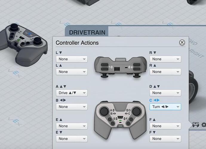

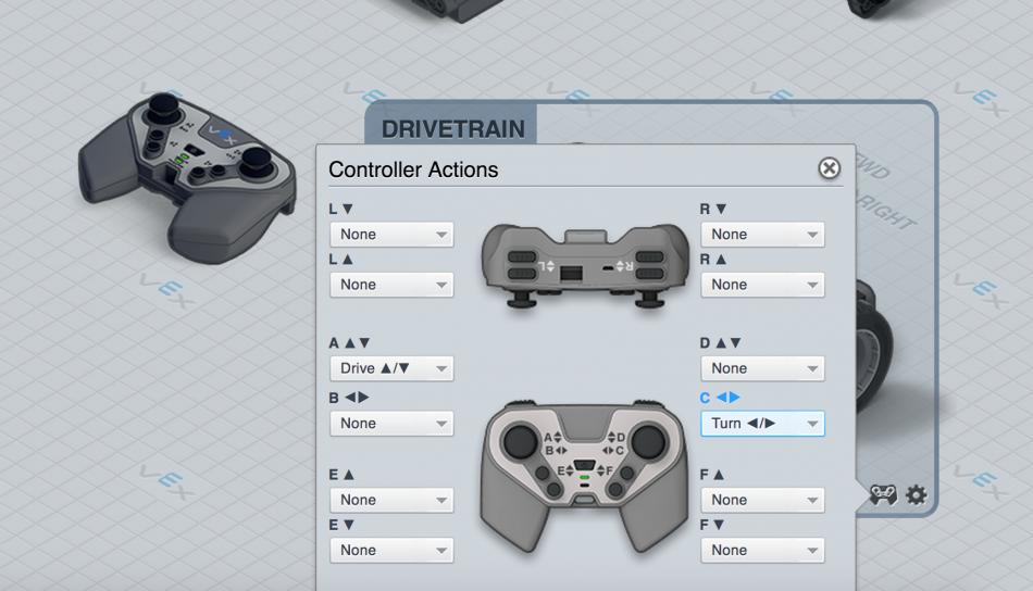

Also make sure that you are dragging the controller onto your program, and that you have included the Drivetrain in your program and mapped the joysticks to it. Once you stop using Driver Control you need to write your own driving routine. In this screen print I have the left joystick mapped to the drivetrain going forward and back, and the right joystick for turning.
