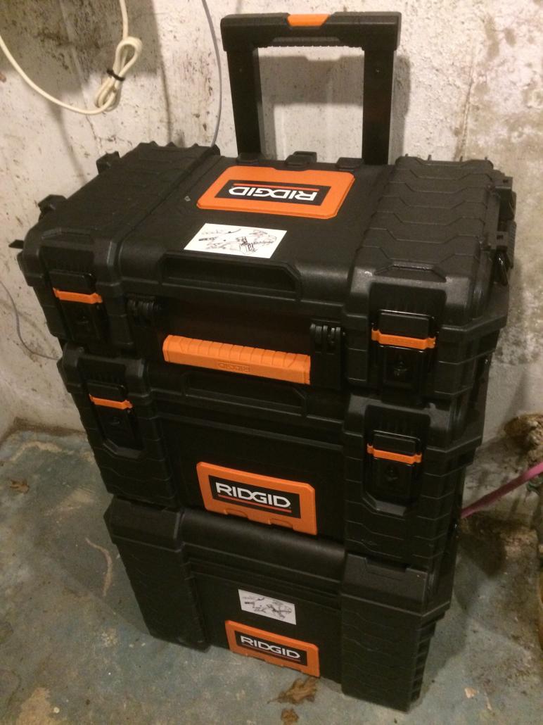

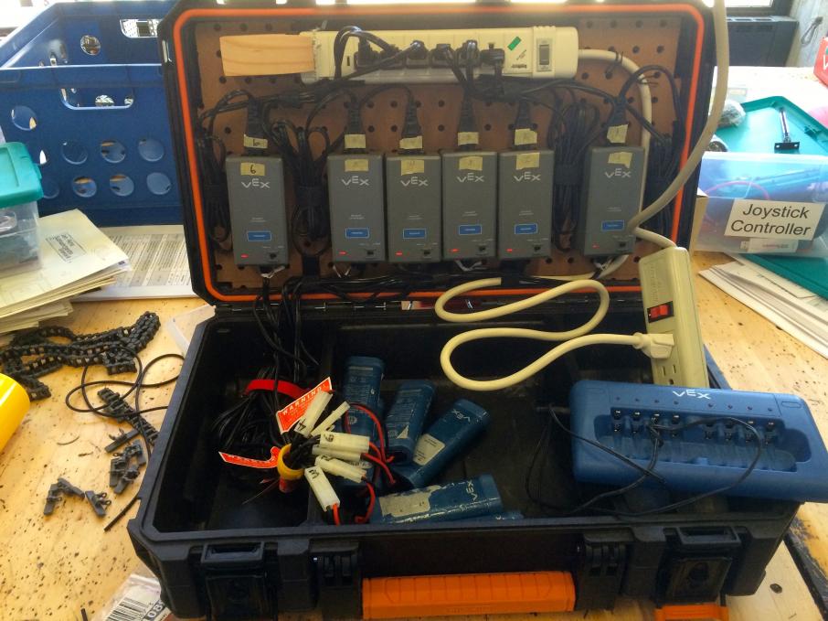

Our club, VRC: 9791, built a charging station around the Rigid interlocking tool case system. You can get them at Home Depot, not too expensive and great for competitions… The briefcase is great! We removed the top lid to make more space and then inserted a peg board to hold 6 7.2V chargers. The left side compartment can hold batteries and the cables, the right side compartment holds the AAA charging system. The middle compartment is where we put the second power strip and other battery/power stuff (extension cords, 9V batteries etc). The other boxes in the system are used for parts and tools. The base box has wheels and telescoping handle. You can easily wheel it around. The costs of the tools boxes - base $60, tool box $40, and briefcase $30.
Here is the one we made, we have three of them for 8 teams and it works pretty well. [ATTACH]9187[/ATTACH]

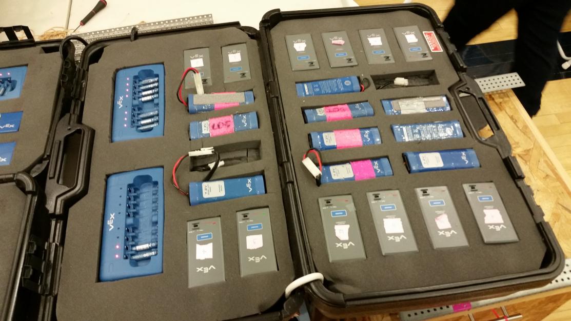

This was board/ carrying case made by a team at one of our competitions. They probably don’t mind me posting this.
