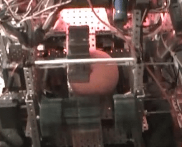

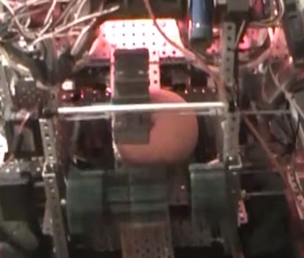

Your centering system is higher quality than your drive train
