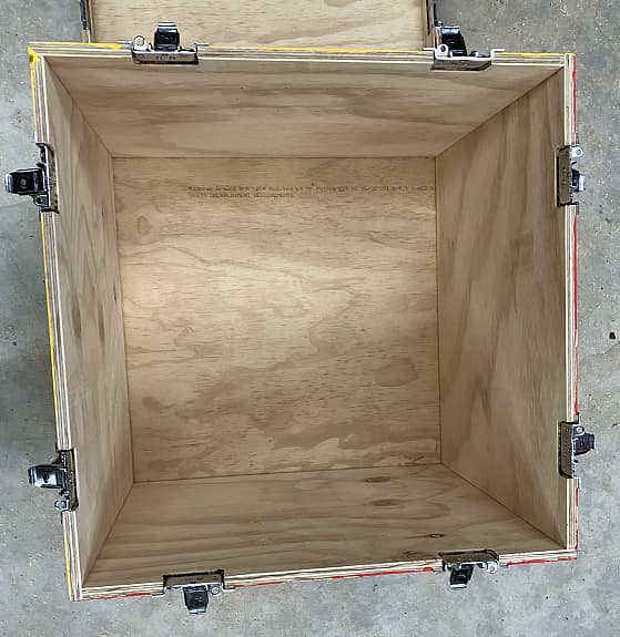

Can build yourself some, but cost is still not free.

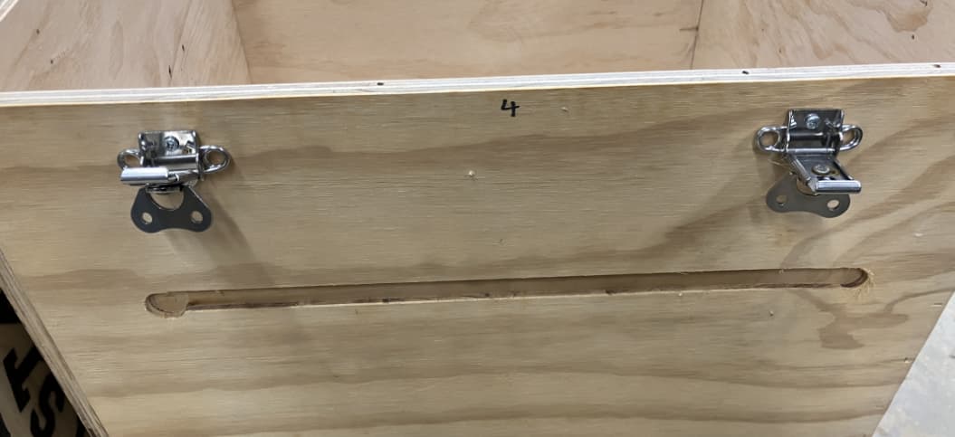

  1. plywood

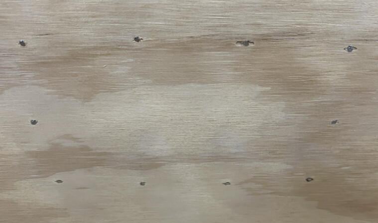

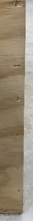

  2. HIGHLY recommend to use STAPLES to assemble box (screws good also, but NO nails)

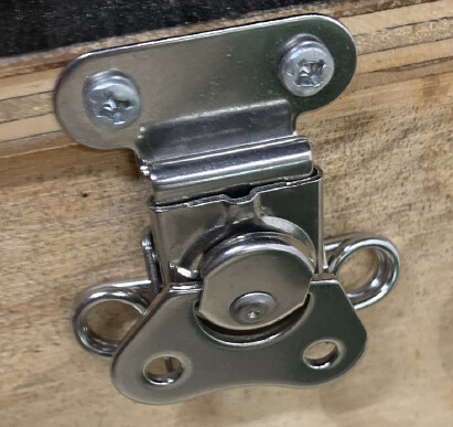

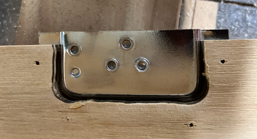

Have used these:

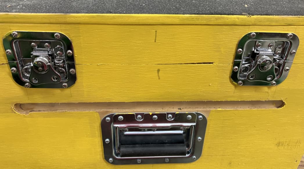

And also these. They are nicer but MUCH harder to install as they have to be recessed into the plywood.
Good handle. Must be recessed, but not hard to do with a router.
Corner protection (optional):
The word on wheels… I’m told airlines don’t like stuff rolling around and will flip your bot onto its side to make it stay put. Maybe robosource said this?
Costs:
1/4 plywood @ home depot $30
latches $15
handles $12
corners $14
TOTAL $71 plus time, gas, tools, etc
Followup… you need 8 latches, 2 per side. So double the latch cost, moving the total to $86.
Re: the second set of latches, ones robosource uses. They are nicer, but recessing is a PAIN. And if not done perfectly, you end up with jagged edges of box (on one side) and latches (on the other side).

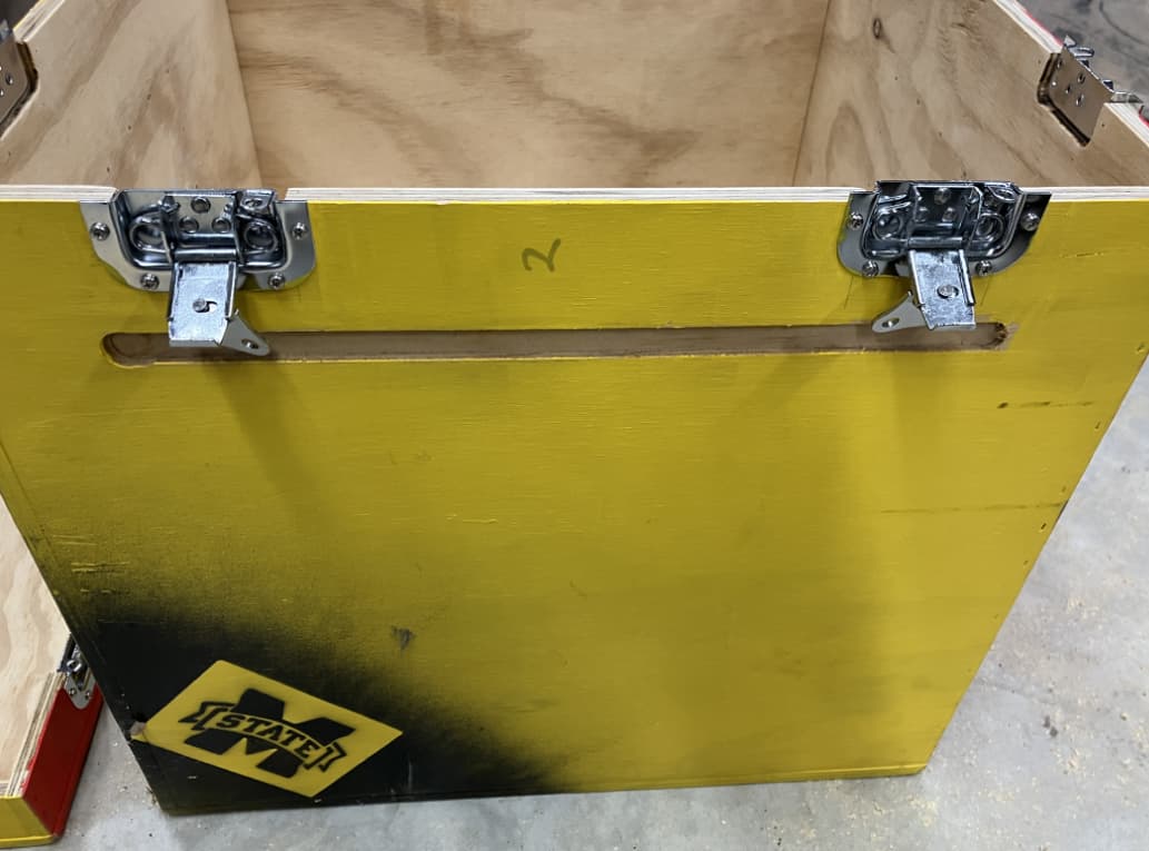

Exposed latch (sharp):
Exposed wood (splinters):
Groove milled into box to provide additional ‘finger grab’ spot when pulling box from tight places.
First latch just screws into place:

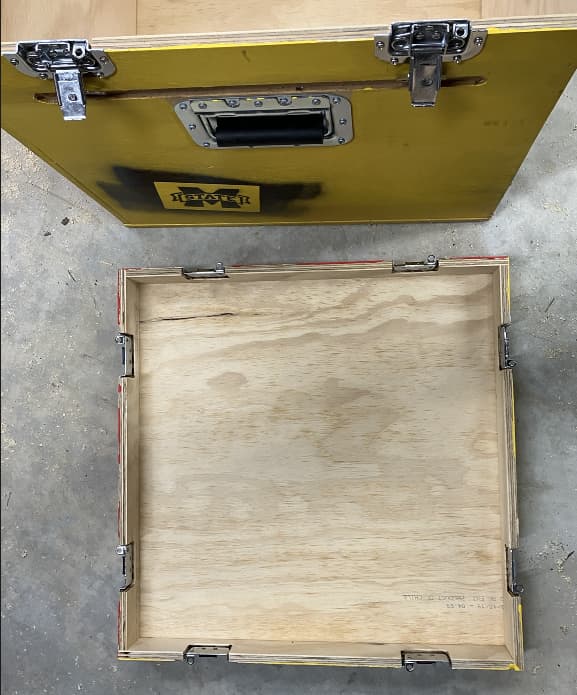

Would love more full photos of this when available

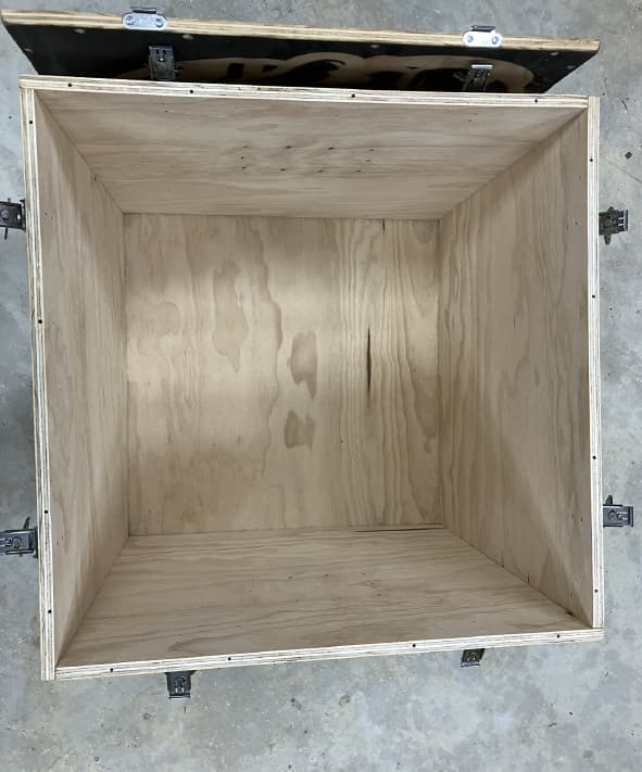

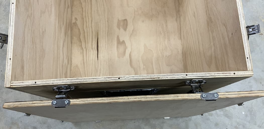

Box 1, all latches open
Box1, lid upside down next to it
Box 1, side view
Box 1, inside view of handle screws, had to grind/sand them down a bit.
Box 1, lid standing upright.

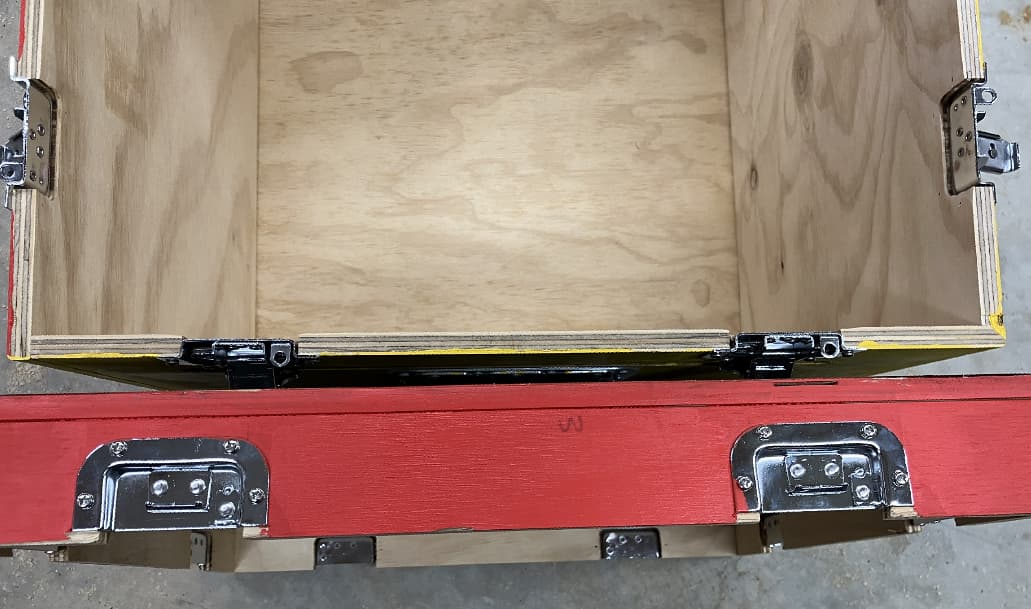

Box 2
Box 2
Box 2
Box 2, staples. Immense holding power.
