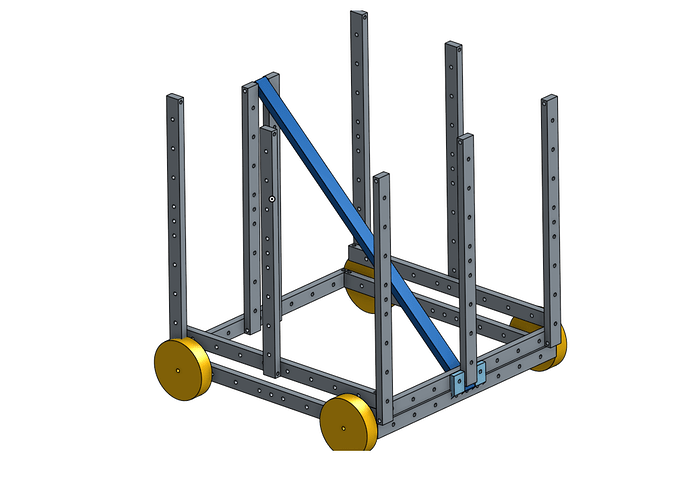

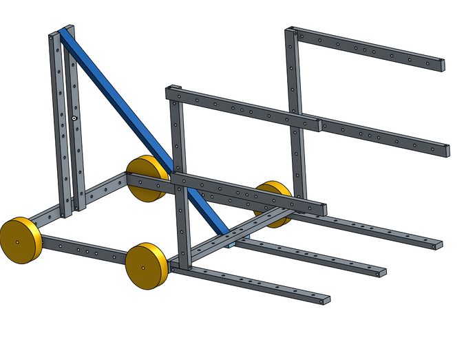

I won’t be participating in VEX this year so I decided to go ahead and release an idea I’ve been cooking up these past two days. This is a rough (very rough) CAD model to show an idea, none of my thoughts have been tested, I don’t have stars, much of this will be hypothetical.

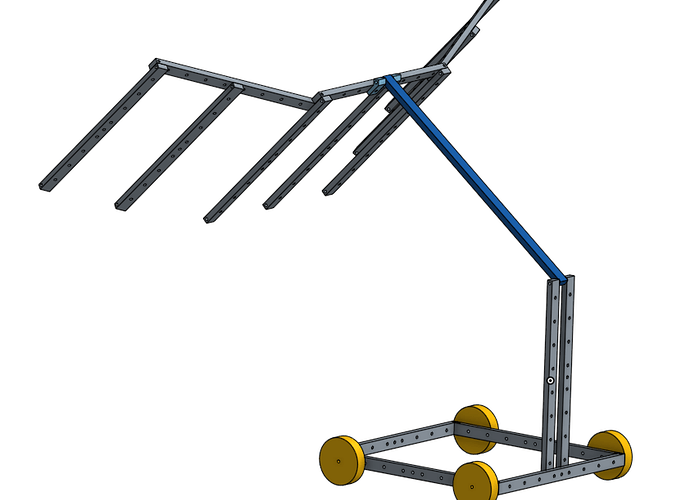

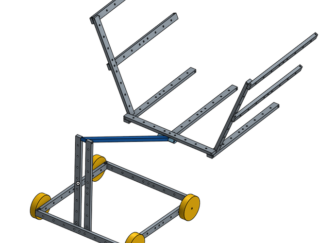

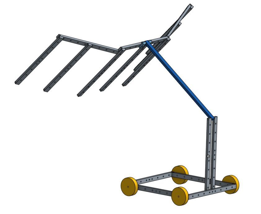

This robot is a dump bot, and is designed to clear a large portion of the field in one sweep, picking up anywhere from 6-9 stars (in theory). Think of a normal dump fork lift, then add two more fork lift trays that are operated by two independent motors, similar to this. The idea is that you can have the advantage of a ridiculously large intake area, while not sacrificing maneuverability because you can fold the two outside trays in actively.
I believe that it could work with just a shoulder joint that allows the robot to dump backwards, but I think the addition of a wrist joint, similar to this one, would allow the robot to dump in front of it, giving the stars the proper spin to roll forward.
The design is very reliant on light, effective, forklifts. I haven’t tested any, the bars you see in the pictures are just to represent a forklift. I think a possibility is poly carbonate strips orientated so that the thickest part is upright, aka it is easy to move left and right, but rigid up and down. Again no proof that it would work though.
I know it will be heavy (in theory it could be built pretty light), but fortunately we can use all of the stored energy we want in the forms of rubber bands. I’m a huge fan of counterweight, there’s no reason for the motors to have to do the work required to lift the actual arm itself when you can use rubber bands. So now all the arm is lifting is the weight of atleast 3 cubes, 9 stars, or some combination for those.

Here are some pictures of the cad. I realize that there is a collision in the front where the lift arm comes down, again this is just to show an idea. There would need to be something on the main arm to allow stars to roll down it so that they don’t fall into the robot when you go to dump backwards.
