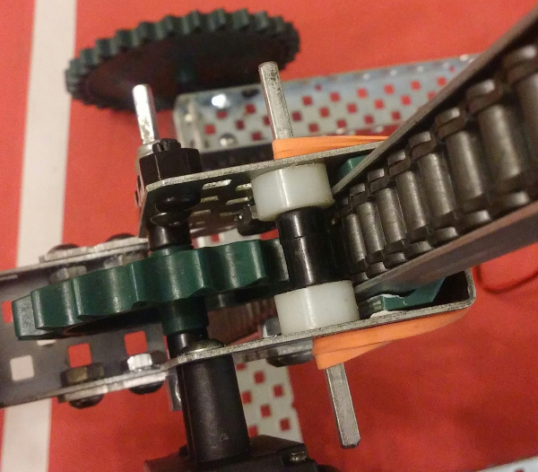

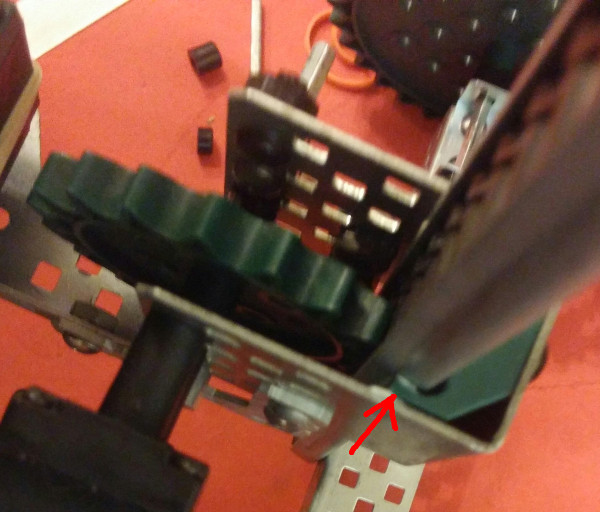

Also, since scissor lift and choppy motors were mentioned … there is a potential mechanical reason that is very specific to the linear slides, that are frequently used with scissors.
If motor is mounted on the linear slide bracket, then when you apply the torque it tries to turn the bracket and jams the sides of the green slider against the linear rail:
This could be either going up or down and mostly depends if motor is mounted asymmetrically and on which side of the bracket.
Lubricating slider will help, but the proper solution would be to add some sort of the rollers:
On the software side, adding slew control will also help, if this was the root cause of the choppy movement.

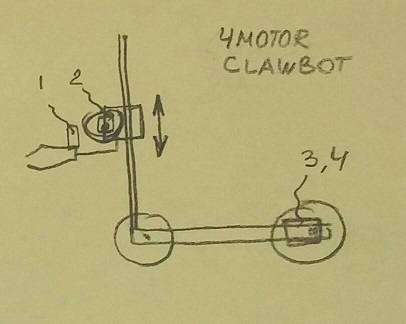

would like to see the rest of that
There wasn’t much of the robot beyond what you have already seen.
Standard vex claw on the front, and two drive motors and the battery on the back.
Minimal4motorClawbot

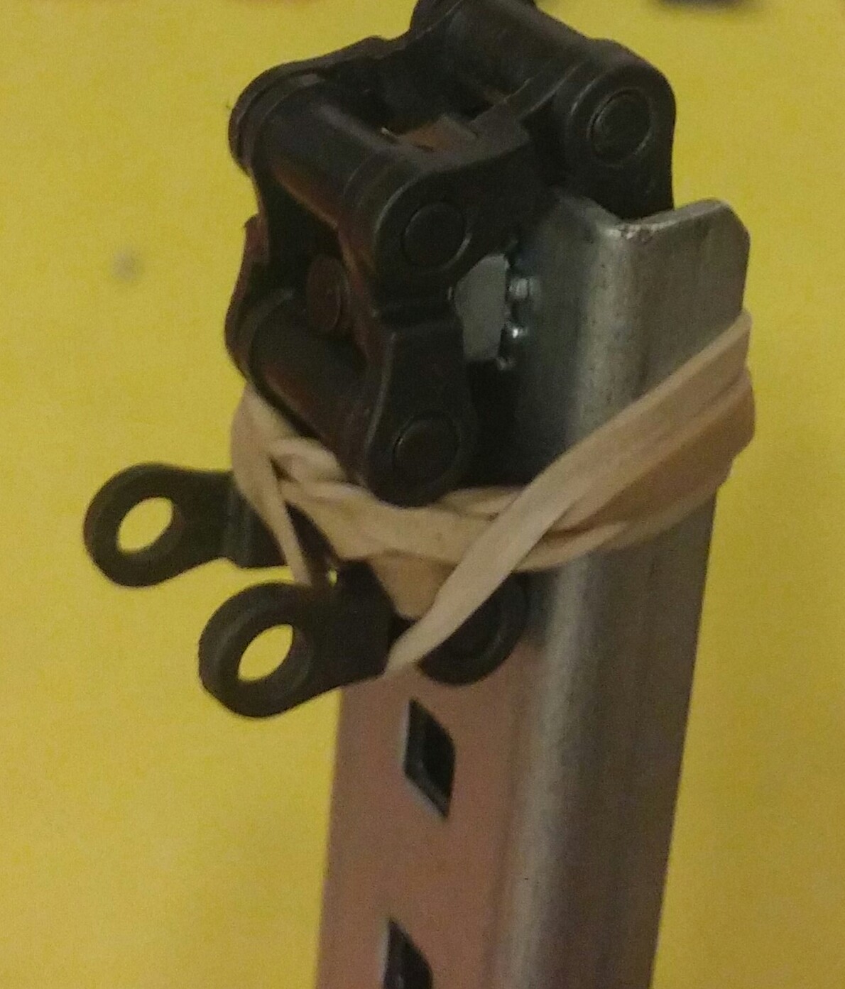

What I’m wondering is how you connect the chain to the slide rail…
I wouldn’t be confident in just sticking a screw through the chain, as that could break it. Looks really interesting, though.

Nice drawing!
All you need is a screw and the rubber band - works surprisingly well:
Well that’s cool. Thank you!
