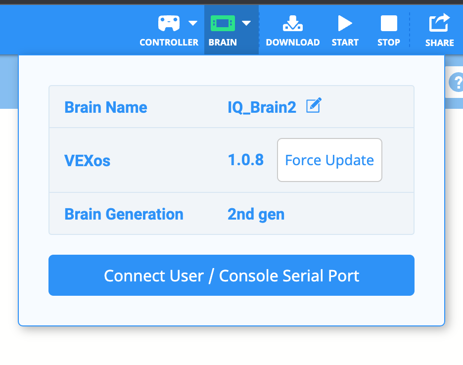

I just started using GEN 2 in my classroom. About 1/3 of my students can’t download programs via USB to the brain. It recognizes there is a brain attached, then when selecting com ports, it is listing "ttyACM and a number, not “com port”. I know they are the same thing, but no Book that gets this when connecting can successfully download a program. No error message when attempting to, it just doesn’t appear on the brain. Things I tried: Switching cables, brain, USB ports, updating firmware on brain . Tried solving every variable and no joy. What am I missing?

Can you confirm that when you select the port for the connection, it shows the brain is connected when you click on the brain button in the top menu? It should looks something like the screenshot below.

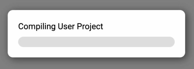

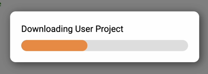

When you do try to download the project to the brain, does the downloading progress bar show up? It looks like the screenshots below. Please note that it may only show up for a second or 2.

Thanks for the quick reply! Sorry I missed some specifics. Yes, we are using the web based version. I use it on my regular laptop and it says “com port” and always works. I connect the brain and it turns green after I have selected one of the ttyACM ports. The download progress bar does show up. I believe I have tried swapping the brain to a working CB, but I’ll try again Monday to be sure. Each student has their own assigned CB they use all day for all classes. IT does lock them down pretty hard, a few new apps are running, I’ll look into that. I did just find out we have a mixture of CB models, I’ll check them on Monday as well. I’ll get that data to you Monday. Thanks so much!
