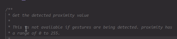

The PROS docs claim that methods for getting color-related data (such as ) off the sensor are “not available” when gesture detection is running (example below from pros::optical::get_proximity):

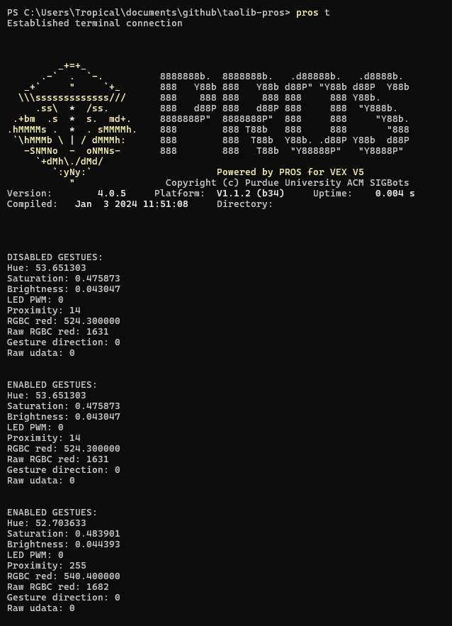

Strangely in my testing this appears to not be true. The sensor is capable of getting RGBC data during gesture detection mode, as well as detecting gesture types at once:

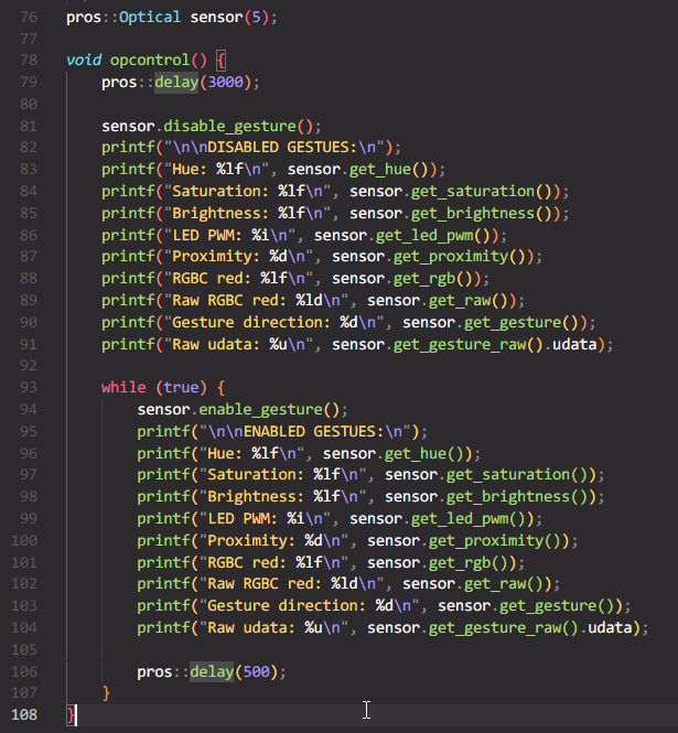

Code used to generate this data:
