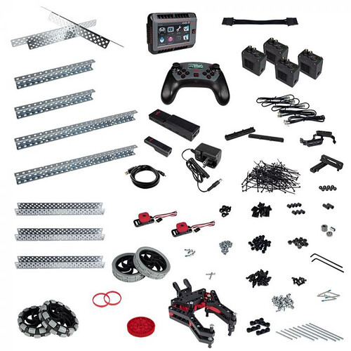

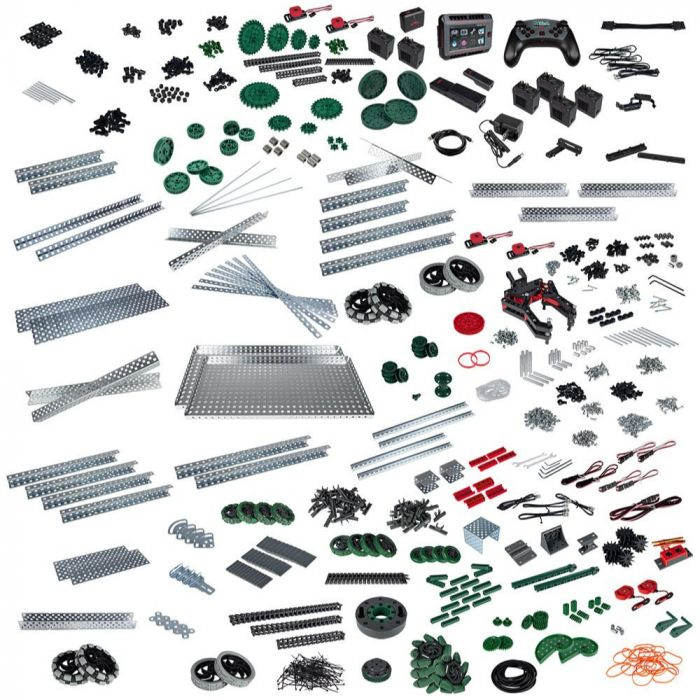

The starter kit will give you enough parts and equipment to build the clawbot, but that is it, you will not have any parts left over. The super kit will give you all of that plus tons of extra pieces and equipment to do other things. If you just compare the pictures between the two you get a good idea:
Starter Kit:
Super Kit:
You may not have a use for everything in the Super Kit, though, so it will be good to know what you need and have a use for. You could consider a middle ground if you are buying multiple kits, say buy 4 Starter Kits and 2 Super Kits.
