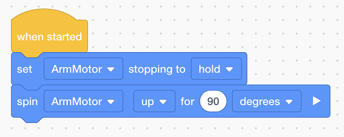

We are Middle School and competing in VRC and using EDR V5. We have built a modified clawbot and when we pick up the block and move to scoring box the arm slowly drops down to the ground as we are moving. How do we add to program to keep tension on this without holding down a button to keep it up? My teacher/coach called it arm sag.

This could be weight of the arm.
spinTo might be your friend here. The next step up would be to occasionally check the motor’s position and spinning it to the difference between your target and your current position. ie k*(target-current) where k is a constant that you set. (this is called a P loop)

since they’re using v5, they could just use motor hold instead of using a P loop.
Are you using VEXcode Blocks or Text? In Blocks, you can set the stopping mode of the motor to hold to have the motor use it’s mechanical strength to keep the arm in the air.
13%20PM
In text, you can use the setStopping command.
  ArmMotor.setStopping(hold);
  ArmMotor.spinFor(90, degrees);
Thank you we got it, it works well now
