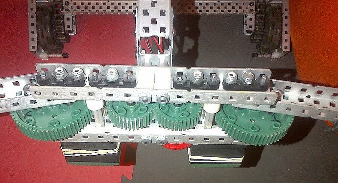

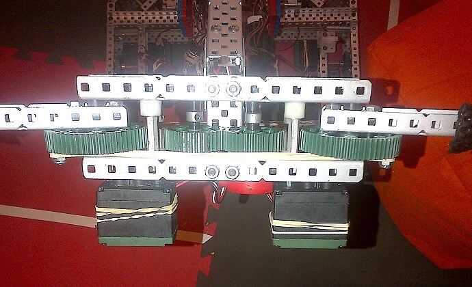

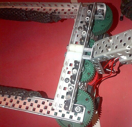

I am not sure why multiple posters (in multiple threads) ask for pictures of the claw design and nobody have posted hi-res pictures yet.
A “classic” 60:12:36:36:12:60 isn’t such a big secret this time of the season and we have seen it in multiple competitions before building our own. It could be driven by two speed geared motors and has some elastics for extra closing force:
It is a bit on a heavy side, but seems to work well for holding both stars and cubes. 60:12:36:36:12:60 is not the only effective design. I’ve seen a claw with 84:36:36:84 gears driven by two torque motors working just as well.
I think the secret to the motorized claws is the distance between arms that is wide enough to hug the cube and narrow enough not to drop a single star. Also rubber bands and/or anti-slip padding help to hold onto the cubes as well.
In this particular design the bearing blocks are sanded on one side to go into the corner of the c-channel. This allows to mount central blocks with just one screw and without the risk of them twisting out of alignment. The c-channels should, probably, be 4 holes wider to allow easier access to motor screws without a need to remove the arms:
