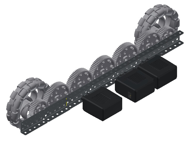

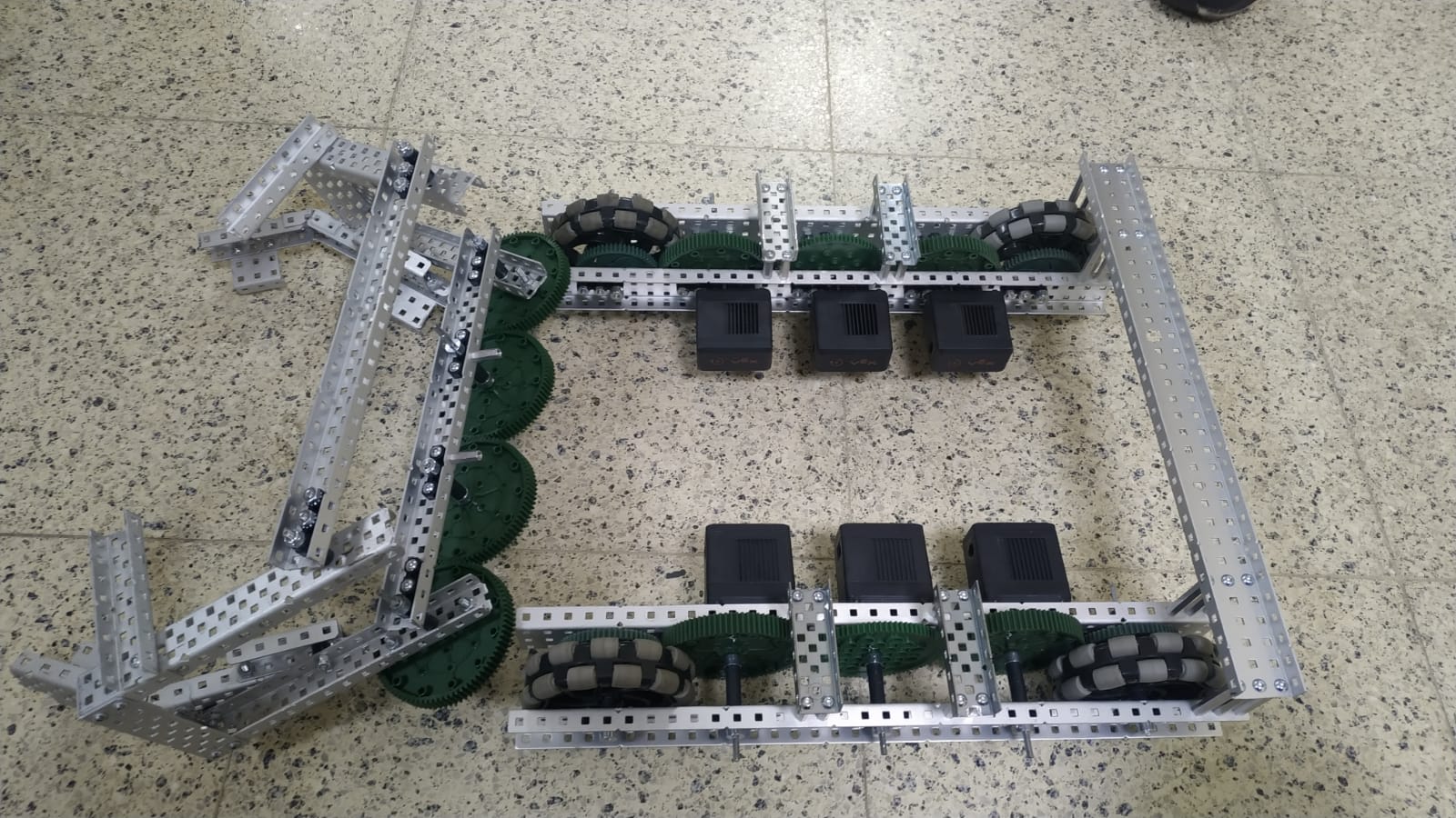

Me and my team were trying to build a Clawbot (with 3141Z’s design) but we couldn’t find a way to not exceed the 18" limit. We had to make our chassis (not complete yet) out of 35 hole C channels to cram 6 motors so it reaches the limit by itself :D. The claw won’t take the MOGO unless it’s close to the ground but wheels prevent that. Any Ideas?
Edit: Drive is 4" 6m 84:60 with 200rpm cartridges. We don’t have 600rpm or 3.25" wheels.

I forgot to add but the arms can already fold backwards. Unfortunately the chassis is almost 18" so the c channel and 84t gears are enough to get it over the limit.

Are those 84 tooth gears for the drivetrain? Many teams are using 60 which could shave quite a bit of length.

If there are five 60 t gears on your drivetrain then there are five spots where you can place motors. Also motors can be flipped in different orientations to take advantage of space.

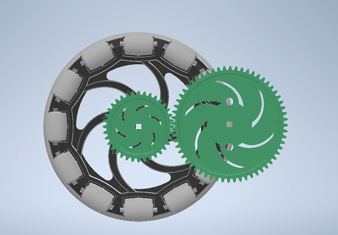

60t:36t or smaller doesn’t work on 4" wheels (as seen in image below shaft collides with the wheel) and we couldn’t afford buying 3.25" wheels or 600rpm motor cartridges.
I understand your problem better. It’s tight unless you had room to go vertical.
Try shortening your drive, probably the best thing you can do. Or just redesign your claw
You could just raise one of your motors and then shorten the distance between the wheels

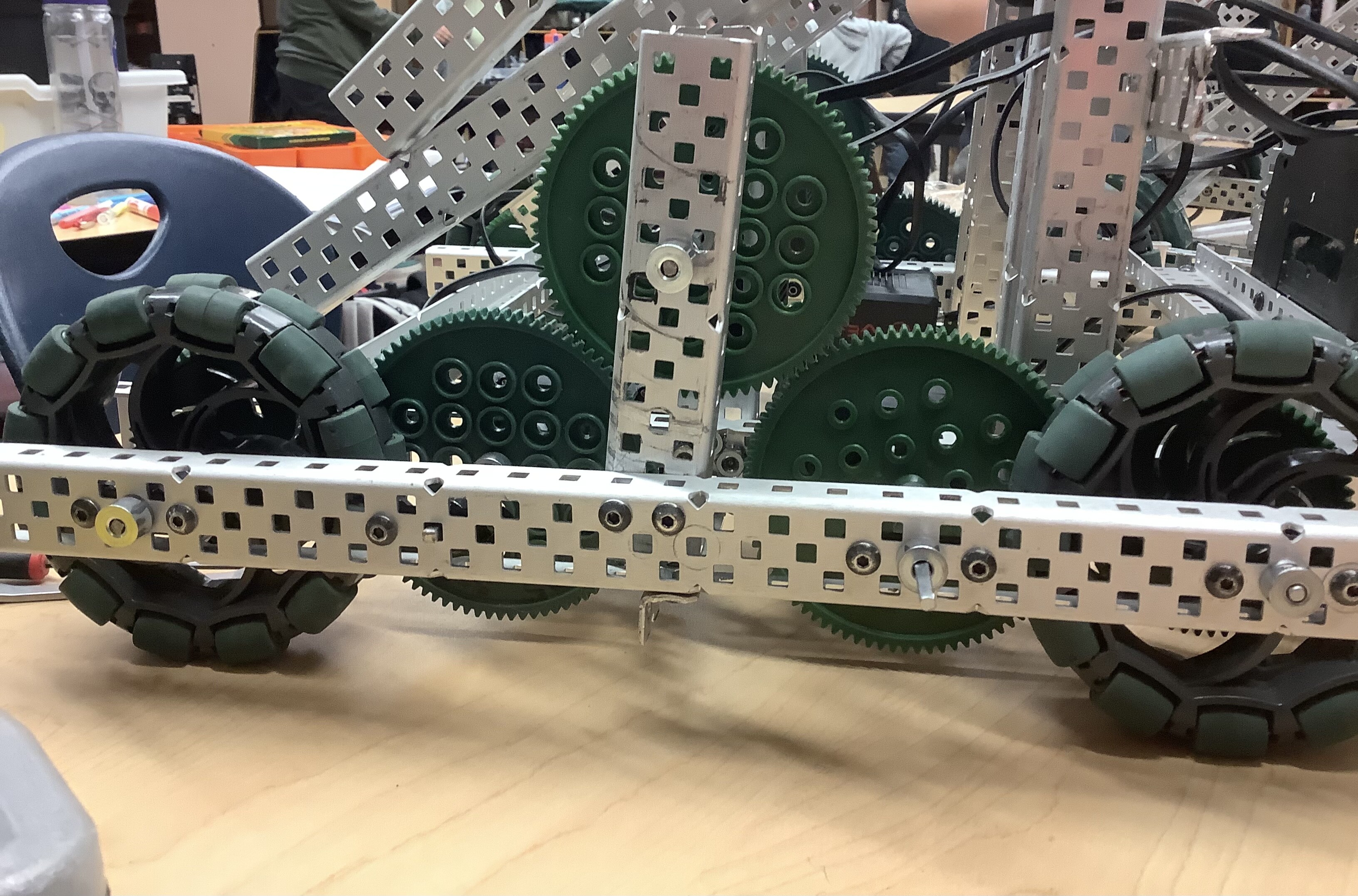

How far out of the 18 inches are you when the claw is as far back as it can be? Just like what Ryan918, and Hudsonville_Robotics mentioned moving one of your motors and gear in the 6-Motor drive up a little bit could save you lots of room. Here is an example of what we tried.
