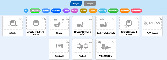

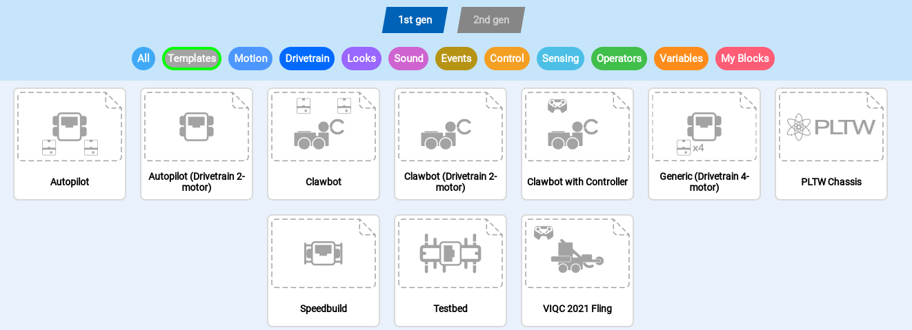

If you have VEXcode IQ, go to File > Open Examples > Templates:
I could help further if I knew what kind of a robot you were using, but I think the “Clawbot with Controller” program is pretty close to the built-in Drive program. Basically, if you want to keep the arm from falling down, you’re going to have to start programming. I’ll be happy to help with anything else you need to figure out!

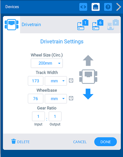

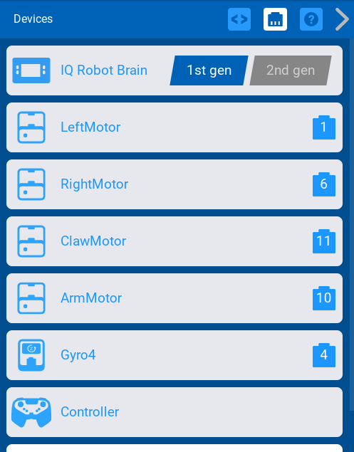

The first thing you’ll probably want to change is the Drivetrain configuration. Delete the “LeftMotor” and “RightMotor” in the configuration panel:
You do this by clicking the rectangle and then clicking “Delete”. Then go into “Add a device” and “2-motor drivetrain”. I can’t explain it all to you, so here are some beginner videos from VEX. Try #18, “Device Setup - Drivetrain”. I think it should be pretty step-by-step, and your motors are probably in the same ports.

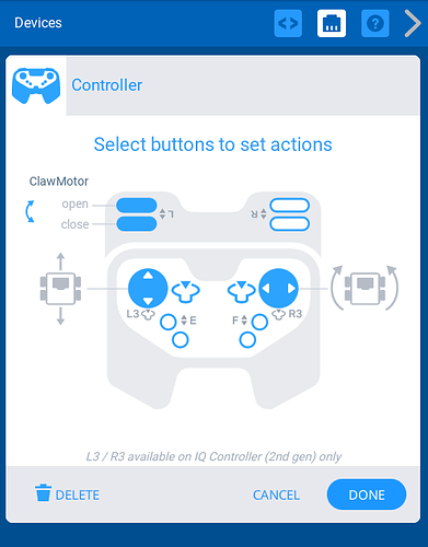

Then click on the “Controller” rectangle and then click on the joysticks until they show the kind of driving you want, and then “Done”.
For example, this icon mean split-arcade:
The left joystick controls forward-backward and the right controls turning. Then click whichever buttons you want to control things, for example, the left trigger buttons to control the claw motor:
Click the little arrow next to “open” and “close” to switch the buttons and keep clicking the buttons until you get the device you want.

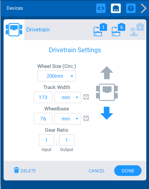

Have you chosen the right sides for the motor when setting up the drive chain? Or reverse the motor in the config for the drivetrain?
This is something I hadn’t thought of. @shouts12, make sure when you edit the drivetrain, and it shows “Left drive motor port”, the port it shows is the one your left drive motor is plugged into. Entering the left port as the right motor and the right as the left would cause forward and backward to be right but turning to be wrong.
