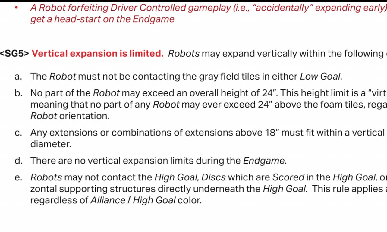

On the chance I’m just really confused or the hope that they can do this, I have to ask for clarification. I have a student team of three that is adamant they want a bot that pushes and lifts (not using any kind of fly wheels). I know about the no touching the high goals rule but then I read this and is a clawbot mechanism (just in idea not last years style) even legal before they redesign? They were thinking about lifting the front end of a disco (which is aluminum) and escalating the disks into the goal. They can’t do anything vertical from inside the low goal brackets?
This thread talks about clawbot legality.
Yes, as stated in the rule you quoted, no expansion at all above 18” is allowed inside the low goal, and outside the low goal it is heavily restricted. This makes it impossible to make a legal robot that lifts the discs into the goal.
That’s what I thought but we literally just competed against a clawbot so I left confused and the kids left with a new idea. Thank you guys for confirming! I’ll message that team now that it’s def a no go.

As to the OP’s original comment, it would certainly be fine to adapt elements of the various predesigned trainer builds to the current game, within the boundary of the rules. But without building some sort of launcher, you can’t score in the high goal and stay within the limitations of the game manual.
