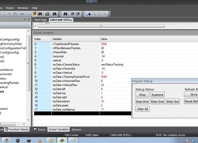

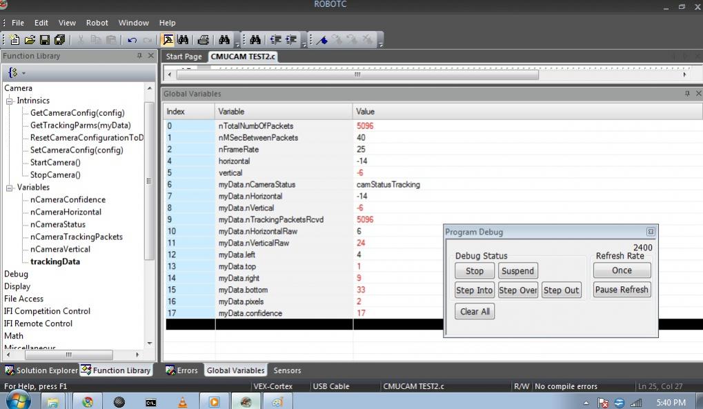

Hey, I’m seeing that in your screen capture that you actually have the CMU camera functions in the function library…how do you get that?
