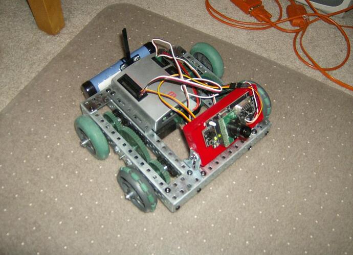

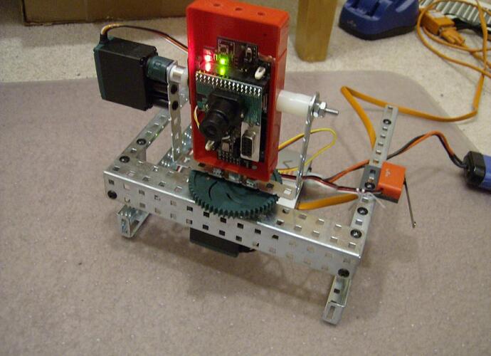

Fun with the cmucam and VEX
Squarebot:
Photo and code.
Tracker:
Photo and code.
Code in MPLB with WPILib.
Never could get the WPILib code to read the camera output. Finally just set the camera to send ASCII data and parced it.
Enjoy!
