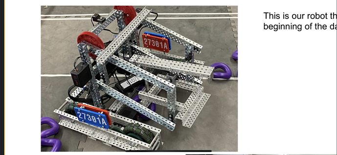

Hi there, my 27301 A team is having issues with their robot spinning all over the place, not sure if its the inertial sensor acting up, but it drives forward no issues, but turning it just starts spinning. Could someone just see if I missed anything? I cant tell what else is wrong:

The calibration of the inertial sensor takes about 2 seconds. If you begin moving before it calibrates then it will not function properly. It’s hard to tell if you are manually accounting for this delay or not, but if not then that may be your problem.
Should we be putting a wait command before everything? This is our 15 sec auto and 1 min skills run.
What wheels are you using?
4” Omni wheels.
They moved the inertial sensor to the bottom of the robot hoping that would fix it
As @Grillied stated, the inertial takes time to calibrate. Normally this would be done before auton (we would put a very complex and unnecessary code under driver, and we would run it before plugging the controller in, but I believe this can also be done in initialization, someone fact check that). That is probably your problem if the robot is spinning during auton.
I agree with what @Grillied and @soar said. Try what they said and see if it fixed.
Thanks everyone, kinda came down to we think something is wrong with the inertial sensor, need to try and replace, I hope have one still in the bag
It might be a good idea to have the team perform diagnostics on the sensor.
Use this link: https://kb.vex.com/hc/en-us/articles/360037382272-Using-the-V5-Inertial-Sensor
See the section called Reading Inertial Sensor Values but the whole article is helpful.
You can also add programming to display the values of the sensor during the programmed run. This may provide insight as to what the sensor is reading.
