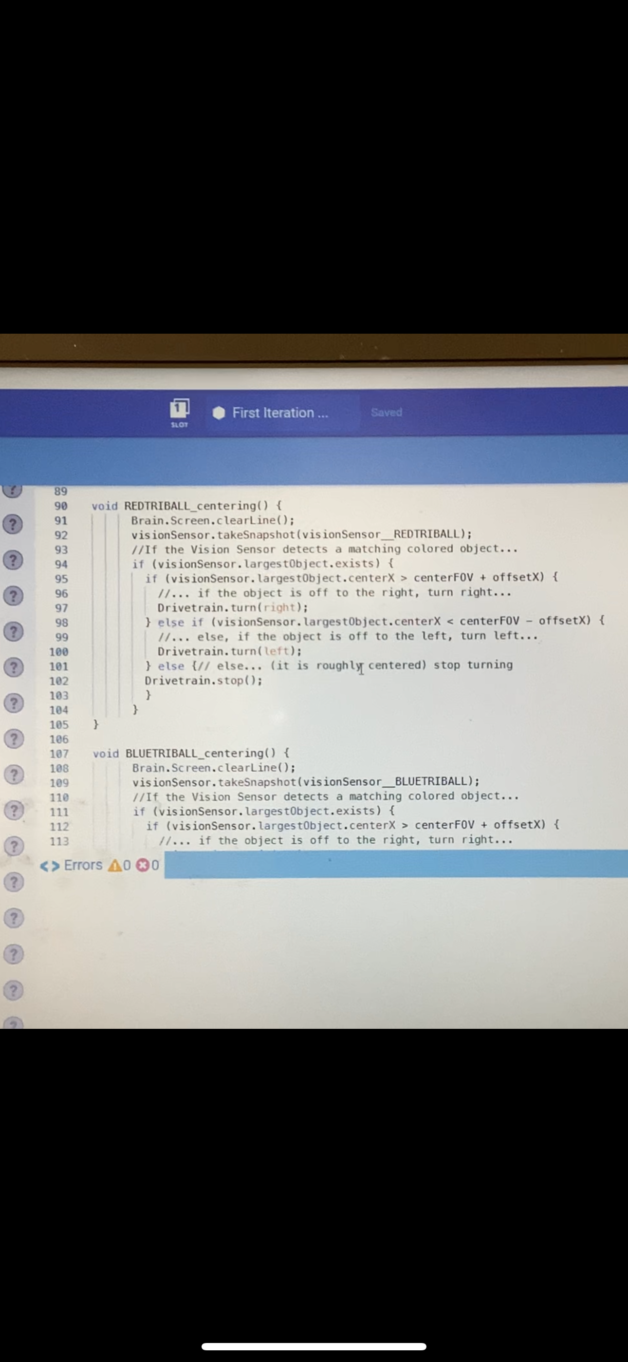

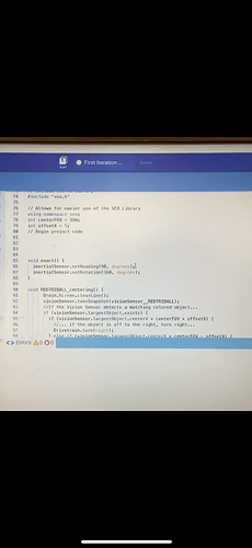

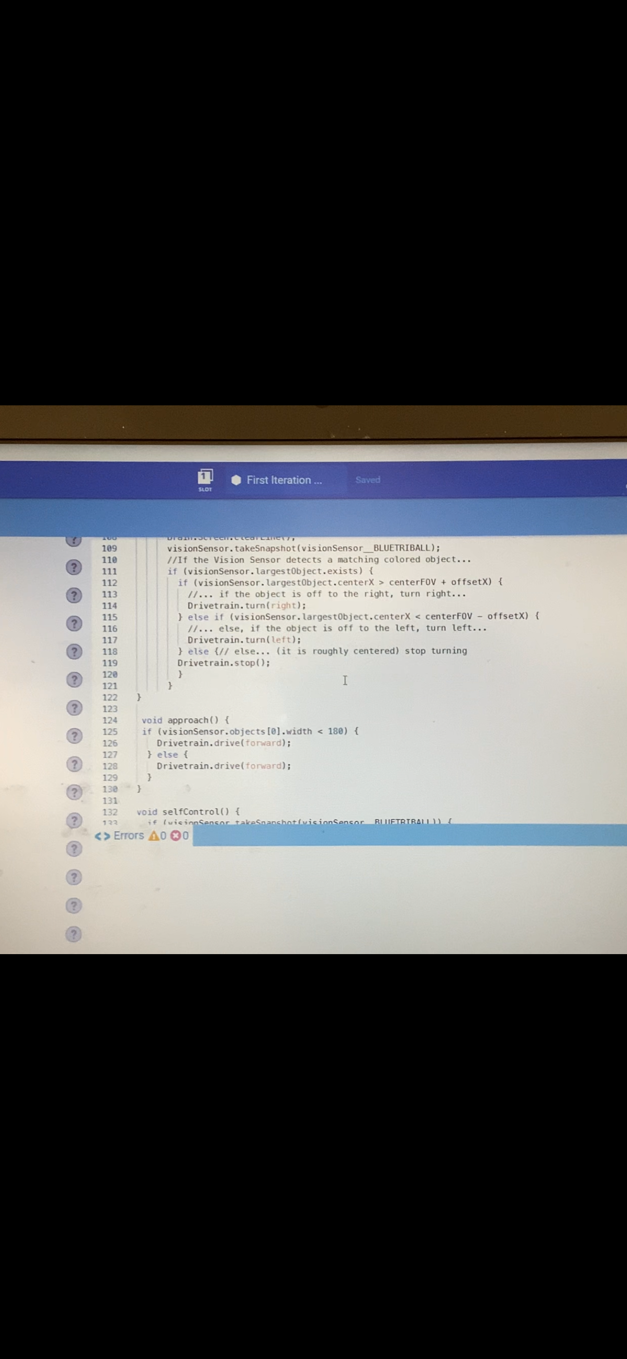

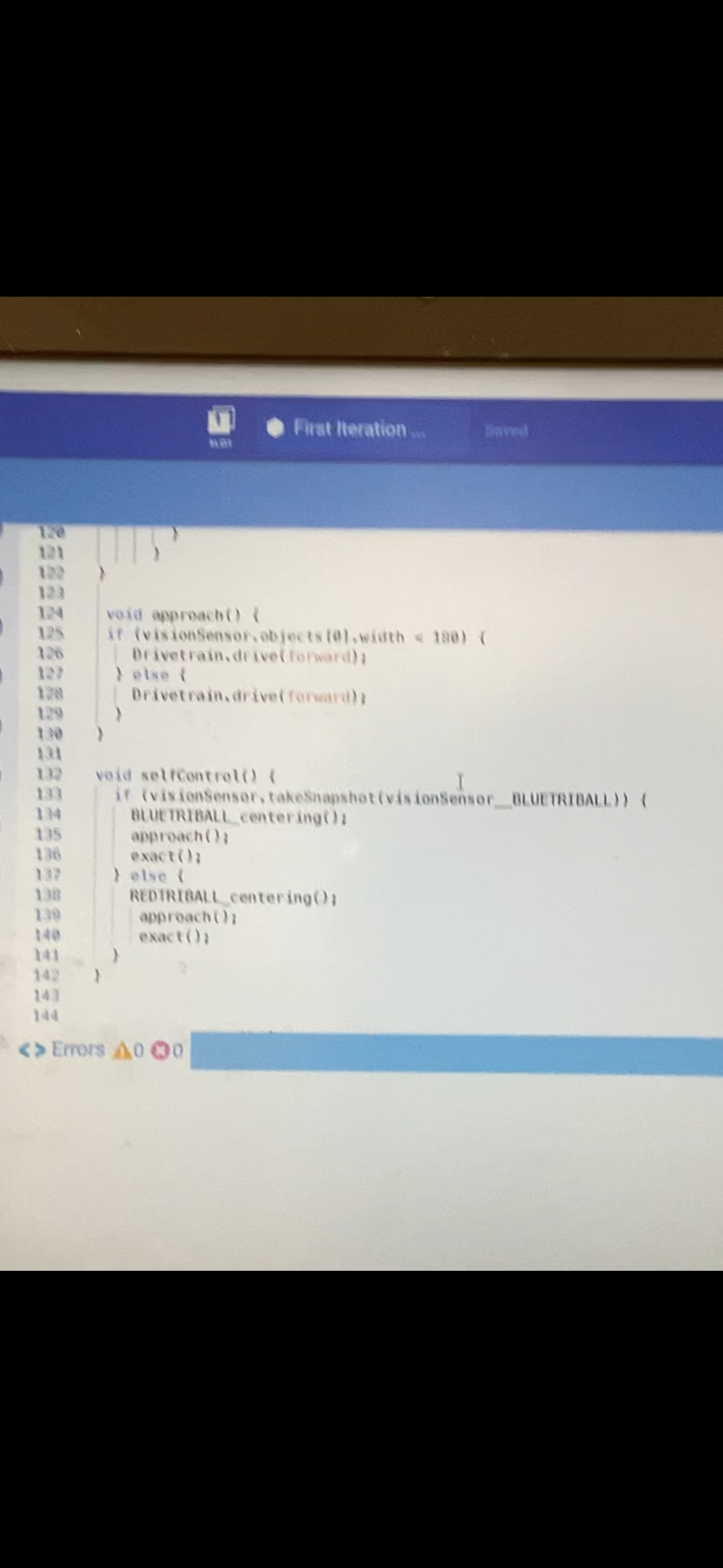

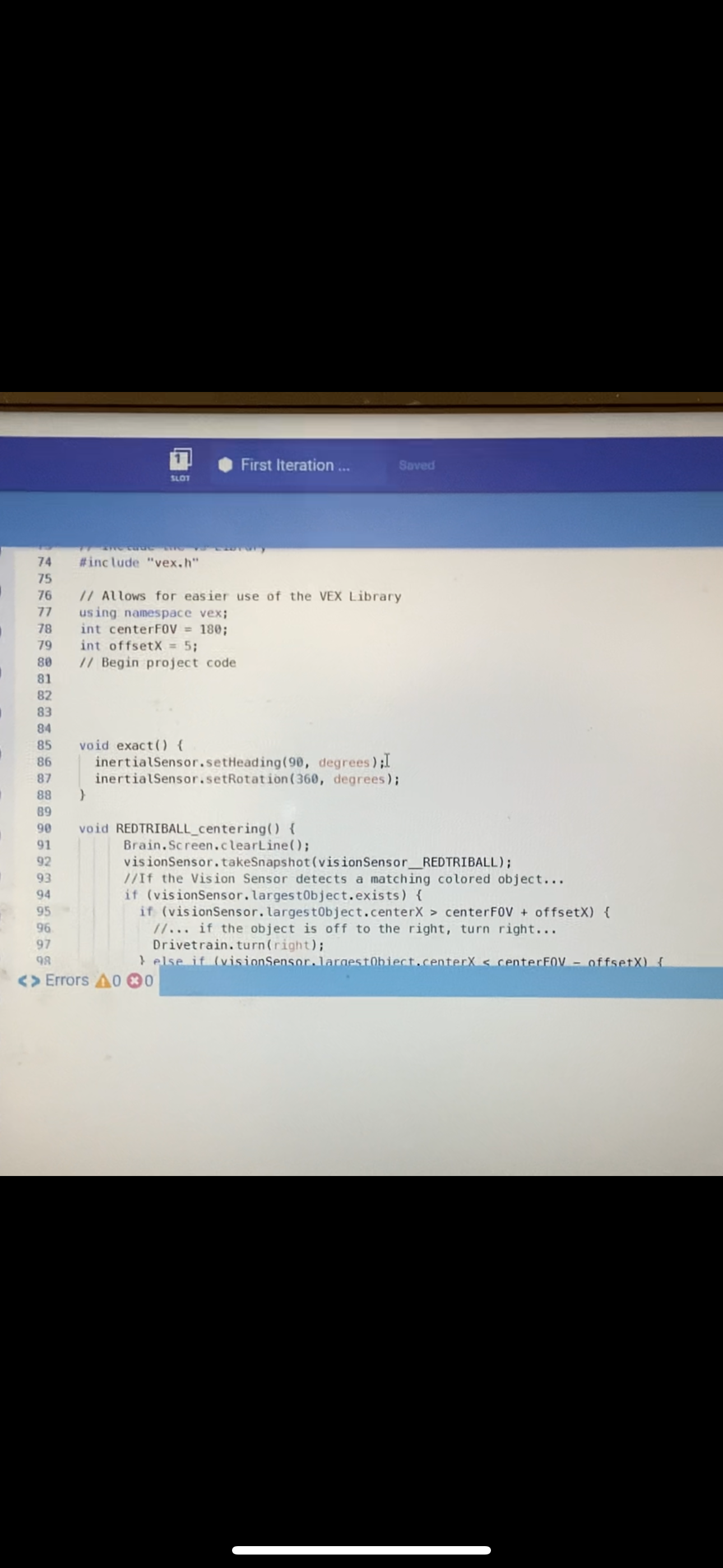

These photos showcase our auton code. We are trying to get the vision sensor to work so it senses the blue triball and the red triball. We have been having trouble with said code as it does not read the red triball and blue triball properly. We have tried signaturing the triballs but yet we see that is not the problem. Is there something wrong with the actual code or am I just really dumb?
