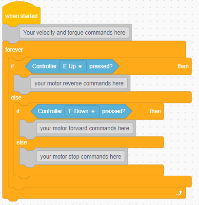

I have created some code for ym vex reverse 4bar and have got some code making it turn forward and backwards when I clicka button but I need help with creating code so when I release the button it stops the arm

This is the code that I have so far, I would like to be able to stop ti when I release E. (Don’t mind the forever block I just did that by accident)
is there a block for the if statement for not pressed? And also a stop block?

This is an option. You need to nest some if/else statements. The logic goes something like this:
If E up is pressed, spin the motor forwards
Else if E down is pressed, spin the motors the other way
Else (i.e. neither E Up nor E Down are pressed), stop the motors

When I use drive control on my arm, it works perfectly fine but when I use this code m arm breaks for some reason.
Please refer to my post further up.
The code you posted will only make the arm go in one direction forever and never stop.
Use the nested structure that I recommended and make sure it is all inside the forever loop.

Nearly. Put your holds up the top with your torque etc as these are just config blocks. In the last else, you need the motor stop blocks instead.
Thanks soo much, it works a lot better now
