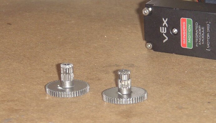

@Vexooooyea, assuming the functions that @callen had suggested will work for you, I would caution from suddenly sending motors high levels of power.
If there is no load or a very light load attached to the motor, that may be fine, but it would still put stress on the internal gears.
However, if there is load attached to the motor, then sudden power increases are know n to eventually shred internal gears:
You would need to apply some sort of slew control, where instead of one sudden jump, you increase motor power in several small steps. Let say 10 power unit every 20 msec.
