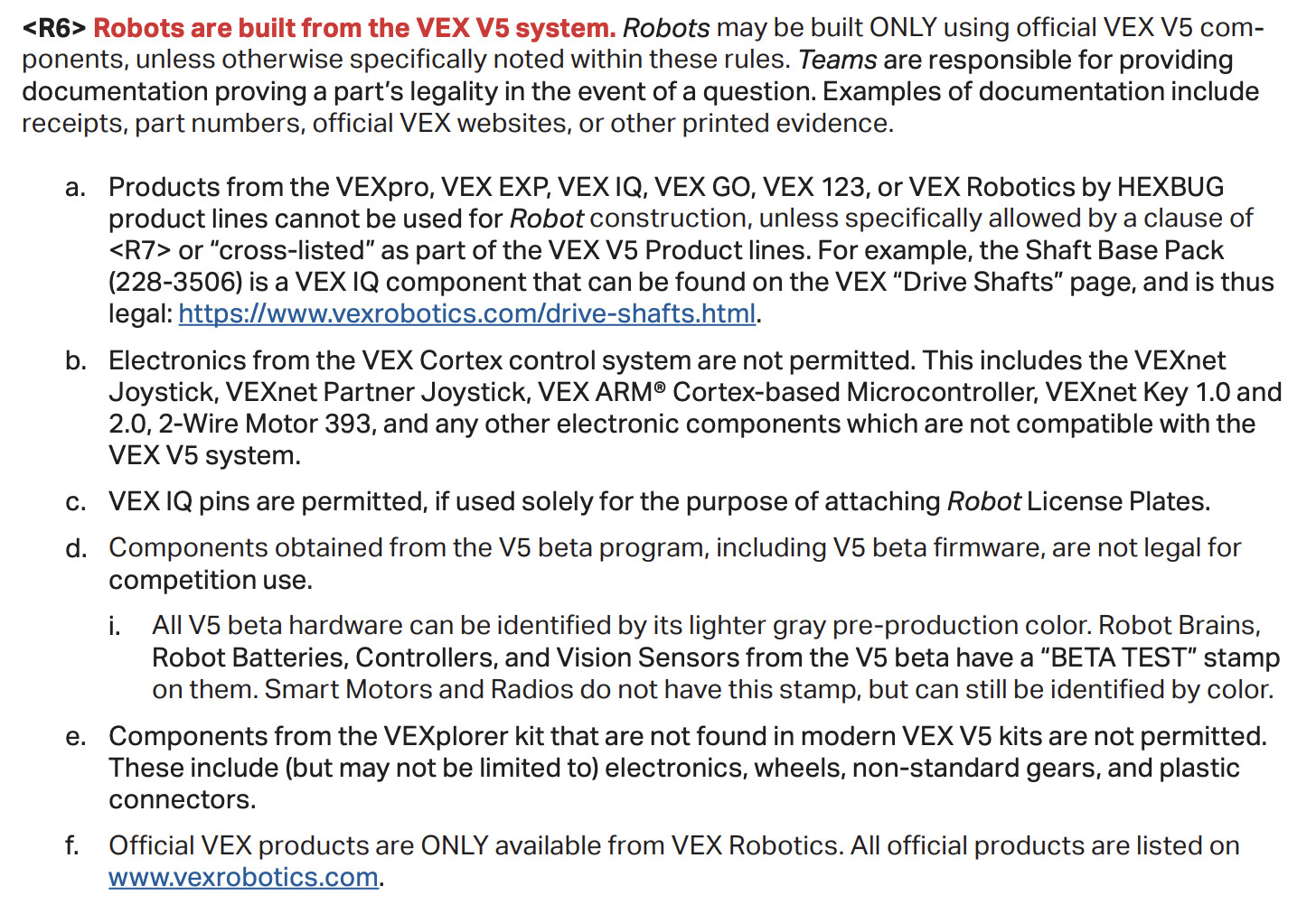

I think @Pyrotechnics is correct in questioning the jumper clips legality.
This would be how you would wire and program it, but per <R6b>, cortex parts are not allowed (unless cross-listed as v5, see <R6a>), and the jumper product page only lists them as “cortex” components, not “V5” (nor do they appear in searches filtered for “V5” or “VRC Legal”).
Specific Rule
Due to this, I [personally] have doubts about their legality, and would caution against using them on a competition robot. Use at your own risk, and remember that
Teams are responsible for providing documentation proving a part’s legality in the event of a question.
One possible workaround could be using a bumper or limit switch in an always closed configuration instead of the jumper clip.
