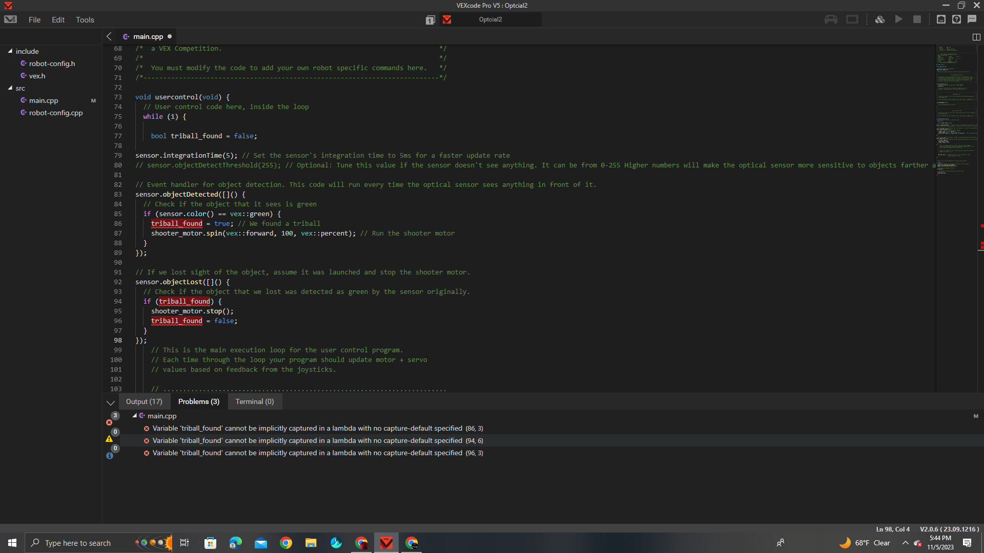

So I tested that code today and the optical sensor did not tell the shooter to shoot the triball I will have some photos of the code soon but I just plugged in the code you sent.
Uploading: A2637041-A6BA-4D51-B9BE-99F65483869A.jpeg…
Here are some photos of the code slap is our shooter sorry if the pictures aren’t the best.
