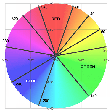

and for reference, you can always check what hue the optical sensor is detecting by using the dashboard.
optical
This can be used while your program is running if needed.
The VEXcode SDK evaluates a range of hue as a color.
red is 340 (-20) to 20 degrees
green is 80 to 140 degrees
blue is 200 to 240 degrees.
If these don’t give the result you want, then call the hue() class member function and set a range of values that matches what you need.
