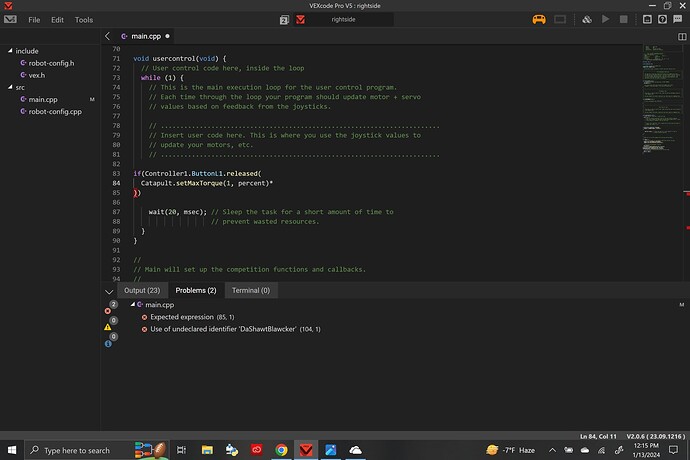

I’m trying to set my motor to a low torque when L1 is released but I’m having some issues because I keep getting an Expected Expression Error here is my code
can someone please help me
I am unsure as to how .released()
works since I get a lot of errors when I try to use it.
